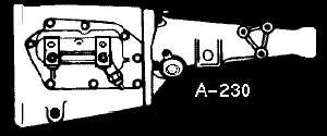

shifter. One swap I have done uses a later A-230 (70 & up) fully
synchronized 3 speed. This is a much stronger gearbox and your
current column shifter can be adapted to it by modifying the side
cover levers and shift rods.
(both
need to be made longer) The downside to this swap is that the A-230
box has the later "slip-in" rear drive shaft yoke and speedo gear
set-up. You would need a different drive shaft and a 66 speedo cable
assembly to get this working in your 64 Dart.
