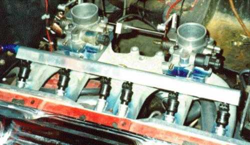

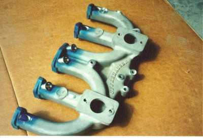

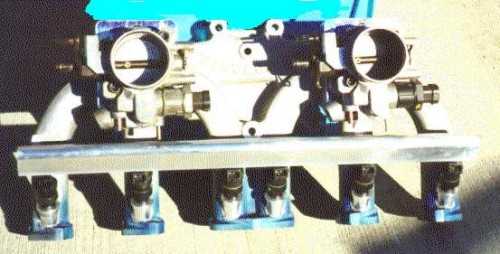

Mounting the injectors is perhaps the most difficult aspect of the project. The injectors should be installed so that the spray pattern points at the back side of the intake valves. We have to get into some machine shop work. Simply using a stock intake manifold would work. However, I had come into possession of a dual carb Offenhauser manifold for the Slant Six. (Imagine the impressive results from that modification!) This is a lot sexier than stock, because we can now run dual throttle bodies, but will probably not result in a noticeable performance increase over one, since the bore on a Fiero throttle body is quite large. |

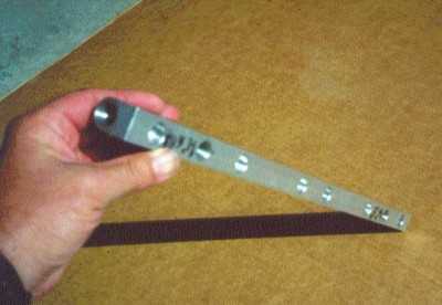

But before installing the injectors, we need a fuel rail. The inlet side of the injectors fits into the fuel rail with o-rings. Again I bought fuel rail material which we then machined to our requirements, determined from a junkyard fuel rail. We then assembled the injectors into the fuel rail and into the bosses and then carefully placed this assembly into the openings machined into the intake manifold. Now it's time for the epoxy. |
After the epoxy set, we deburred and polished the inside of the intake manifold so as not to impede the air flow. The intake side of this setup, up to the ports, will really flow a lot of air with minimal pressure drop. So with porting, polishing and bigger valves (coming later), the air flow potential (hence power) of this engine will be greatly improved. The final part of the intake assembly was making a pair of adapters to mate the Fiero throttle bodies to the Offenhauser manifold. As part of this we opened up the manifold openings to match the 2 1/16 in. diameter of the throttle bodies. |

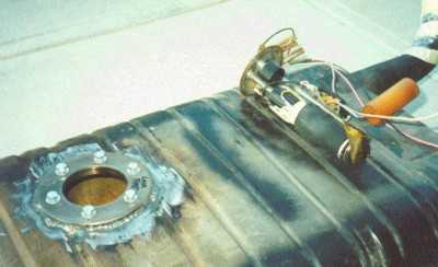

A high pressure fuel pump is
essential; pumps of this type can develop about 90 psi
supply pressure. Again, you can buy after-market units for
several hundred dollars, but I bought a junk yard pump from
a Grand Am. The stock GM pumps are in-tank units, so I had
the tank modified to mount the GM unit, as shown in the
picture. It is recommended that you place a baffle in the
tank to reduce the risk of starving the pump when the tank
level is low. |

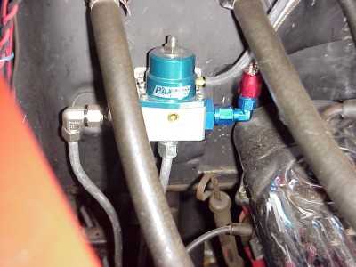

The pressure regulator maintains a constant differential pressure between the fuel supply and the manifold pressure. Whatever the manifold pressure (i.e. vacuum), the fuel supply pressure is a set amount higher. Factory GM units maintain about 40 - 45 psi differential. These regulators are preset and not adjustable. But because the Slant Six and the donor engines have different air flow characteristics, we will need to be able to adjust the differential. In my case, I have found that a differential of 50-55 psi is about right. So I had to purchase an adjustable after-market pressure regulator. Note that these regulators must be referenced to manifold pressure. This is the 1/8" hose shown in the photo. |
After running a 12 volt supply to the fuel pump, and hooking the pressure regulator to the fuel rail, you are ready to pressure the system.
Since I was concerned that I might have some leaks, I did an air pressure test first. Now you would not normally want to pressure test with air, as its dangerous. But the pressure here is not that high by industrial standards, so its ok, and I found and fixed several leaks with a soap test. This is better than having gasoline leaking all over your shop. Make sure you don't include the fuel tank in your pressure test!
Then I ran the pump to pressure the system, found and fixed one more leak and adjusted the pressure to 40 psi as a starting point.

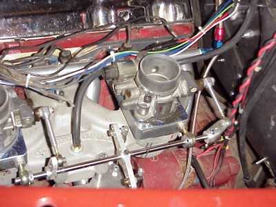

Now that it runs-- Factory FI systems use a stepper motor to allow a controlled amount of air to bypass the throttle body butterfly. This then influences idle speed and the controller signals the stepper until the desired idle speed is achieved. It seems that for street rod purposes we don't need this complication. The Fiero throttle bodies have a manual stop adjustment. I just used this to set the idle speed. If you wanted to drive your rod in our cold weather, this would probably not be satisfactory; you have no fast idle. But it seems just fine for my purposes. |
I put Lorne Hansen to work fabricating some throttle linkage which actuates both butterflies and also has a lever to actuate a throttle pressure cable from Lokar. Another Lokar cable connects to the throttle pedal. At this point I played with fuel pressure and found that the engine seemed to like 50-55 psi (this just by ear). Before we could venture out on the

There is still a slight tendency to stumble when just coming off idle. I believe this is because of the dual throttle bodies. The controller is being deceived, since it is programmed to react to the air flow increase from only one throttle body in proportion to what it sees from the throttle position sensor. Balancing or intentionally unbalancing the throttle bodies at idle may cure this.

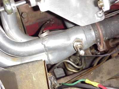

I still need an air cleaner solution. The air temperature and coolant temperature sensor are not permanently mounted. And perhaps the biggest remaining job -permanent mounting and wiring of the controller. Fine tuning the ignition advance curve and the fuel pressure may result in a bit better performance. A more prolonged run at steady highway
speeds will allow "closed loop" operation in which the
output from the oxygen sensor (shown at left) is used by the
controller to fine tune the air fuel ratio by trimming the
injector pulse widths. |
