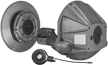

The multi disc race clutch assemblies get pretty fancy but they are well engineered, light weight and in some cases, SFI approved parts. Here is a look at a Quarter Master Super Pro 7.25, 3 disc unit. A clutch like this would be an all custom installation onto a SL6 with flywheel redrilling and some other forms of "re-engineering" work needed. Most of the fast SL6 racers go the extra step of starting with a scatter shield from a V8 and modifying it to mount onto the slant.- DD
