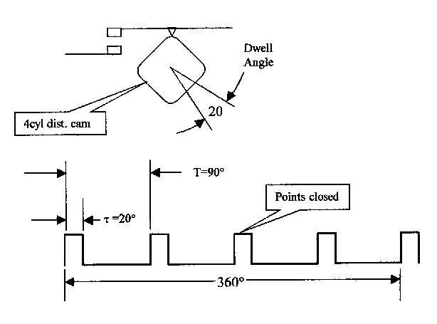

DUTY CYCLE = 1.1 x DWELL
This diagram illustrates the reasoning behind the concept that a dwell meter can be used to measure duty cycle, and that the duty cycle is equal to 1.1 times the dwell angle.
When on the 4-cylinder scale, a reading of 20 degrees dwell indicates
that the points are closed (conducting) a total of 80 degrees (4 *
20) for each 360 degrees of distributor cam rotation, or they are
closed 22% (80 / 360) of the time. In other words, the duty cycle for
the point closure is 22%. This is the same as the dwell * 1.1 (i.e.
20 * 1.1 = 22% duty cycle.)
In this example, 360 degrees is the unit of measure that is used instead of one second. We have a PRF of 4 pulses per 360 degrees, or 4 pulses per unit of measure. So, if we want to use the equation Duty Cycle = PRF * t, then we will have to divide the value of t by 360.
Duty Cycle = PRF * t = 4 * 20/360 = .22 = 22%Also,
Duty Cycle = t / T = 20/90 = .22 = 22%
