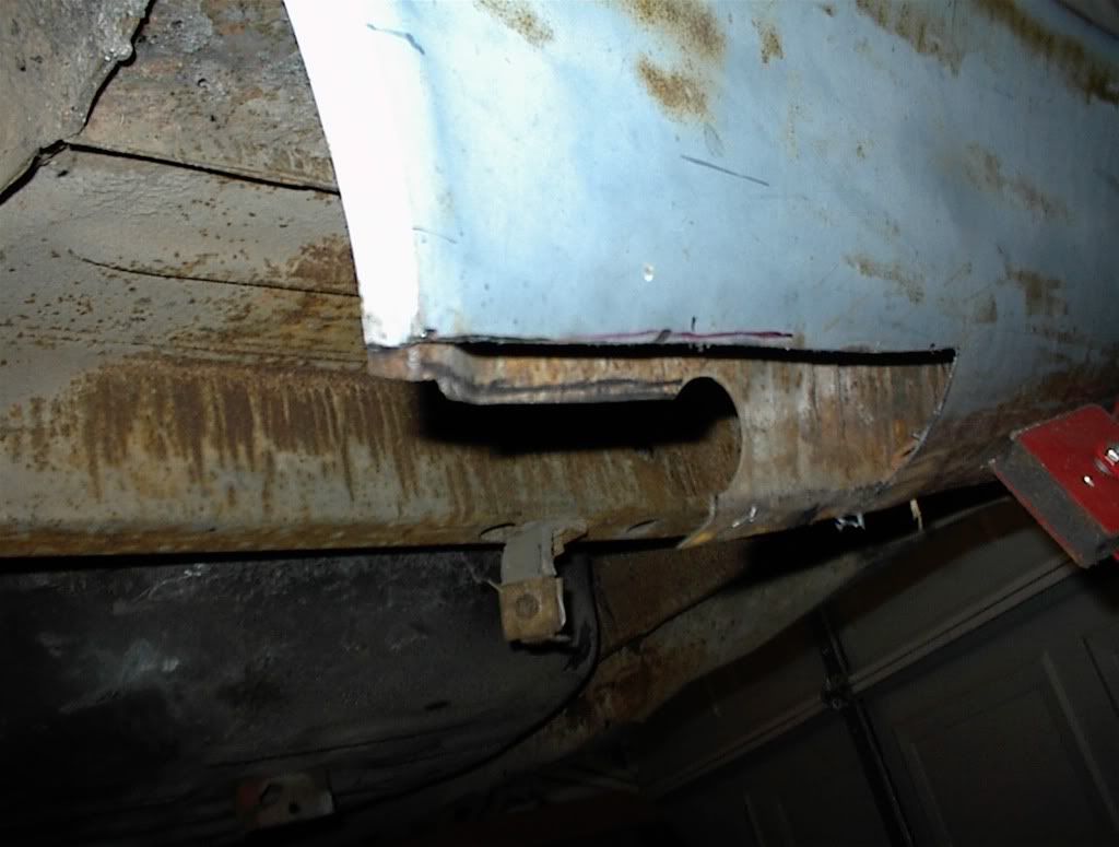

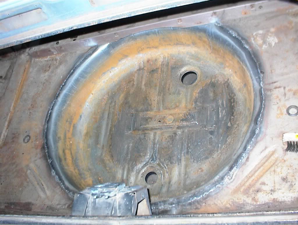

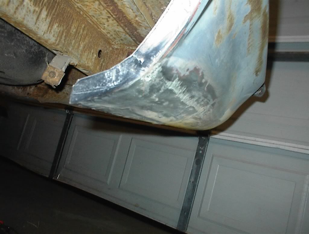

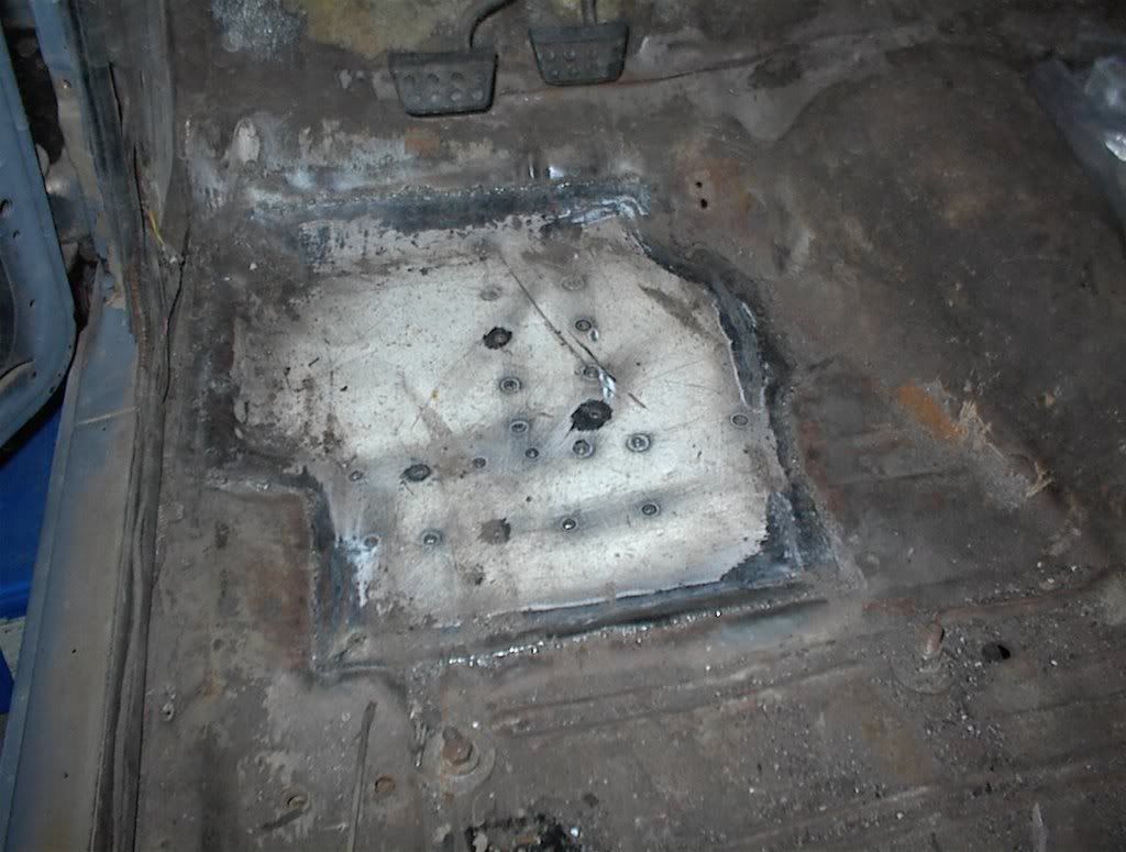

I am at the point with my project were I have to do body work on my 64 barracuda. I have repaired all the rust in the floor and trunk and need to start getting the body ready for painting. Everything has been removed from the car and the body is on jacks. The car has lead a hard life but is all rust free now. While stripping the paint I found some bondo behind the drivers door in the quarter panel and noticed the the rocker panel is slightly bowed up about a 1/4" on the bottom and has a small kink in it. I think I has been hit in the side and maybe highcentered on something? I have managed to beat ou the quarter to a decent shape, but know I am wondering if the frame is straight and if my cars going to go down the road striaght when I finish. I was hoping you guys would have the dimentions to check the body for square. The ones the the body guys use when strightening a car. Here are some pictures of the progress
