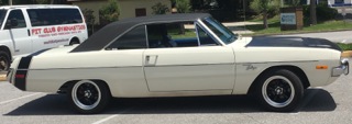

Who has done a 904 to a 4 speed auto conversion. Would use a GM (done Pontiac/Chevy before 200R) if I have to. Don't want to do any cutting to the floor tunnel.
I don't need everyones opinion, just someones take on what trans they used, hands on themselves. Going to a 8.75 with a fairly tall gear (370-411). Power is not going
to be an issue.

You can fit just about any trans in your tunnel without mods. I'm assuming you have a Dodge D100 pickup. I hate to assume but since you provide absolutely no information....

What car? A-body needs substantial tunnel/X-member cutting for a 200-4R or A500 Mopar. Had A500 in my 68 Dart, now 200-4R with Wilcap adapter kit.
Any auto OD will require tunnel/X cutting, almost certainly. Buy a GV OD and put it on your 904 and more minor tunnel cutting well behind the X-member. That is easiest.

Sorry picture didn't download .....A body
