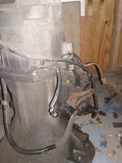

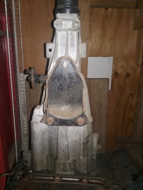

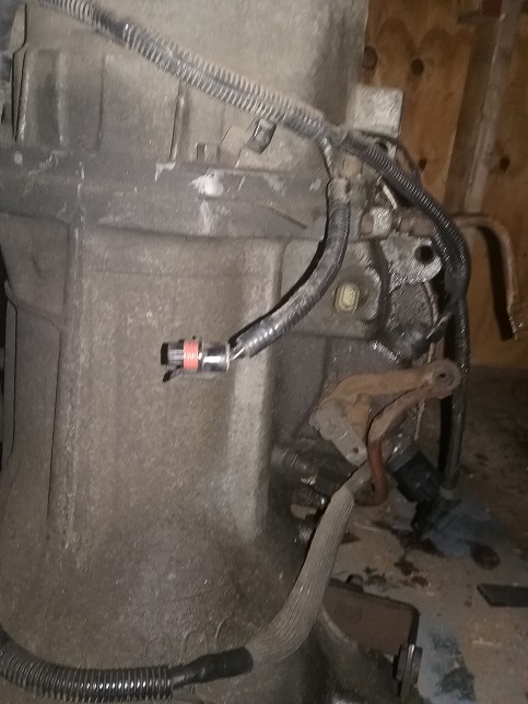

I took a pic of one under my work bench. It's an A500 from a 90 dodge Ram Van.
Thanks! Are you SURE that is an A500? It hought the A500s all had a deeper pan? Would you be willing to take pictures of the top, driver's side, and bottom of the tailshaft housing?
Now I am thinking that maybe the transmission I pulled WAS an A500. I though the A500 and A518 overdirve tailshaft housing had the snap ring access plate on the top of the housing and the 904 has it on the driver's side. Am I wrong?

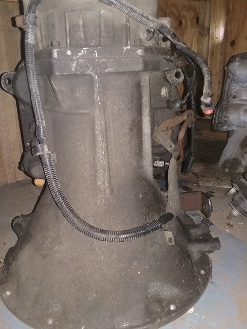

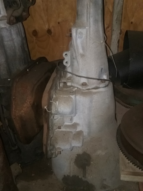

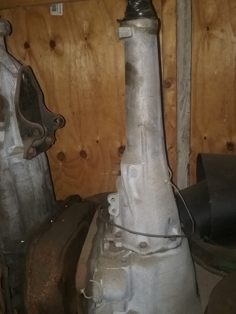

Location: Dallas Texas
The a500 is the one on the left in the pic. Pan is deeper and the od unit is very large at the front part of the tailshaft. The rear mount has 3 bolts and it is 3.5 in longer.

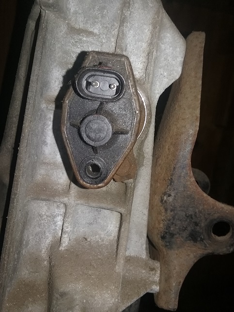

Also make sure the electrical connector (not the nuetral safty switch) is a 3 prong plug. If it is round with about 8-10 wires, it is an re and will not work. You must get one with a hydraulic (rh) govenor not electroic one (re).

How's this?
