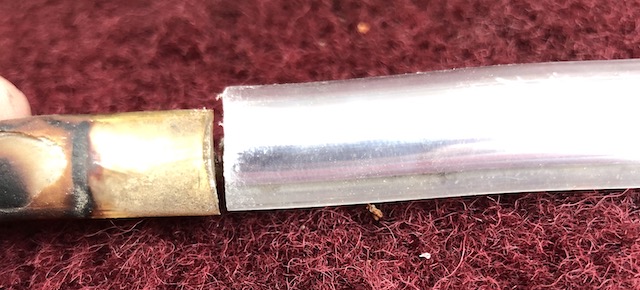

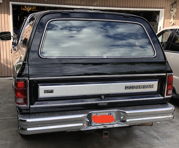

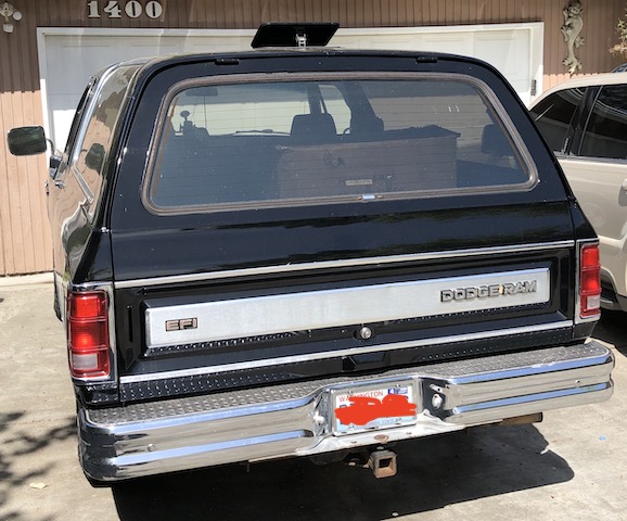

I was able to use the lockstrip tool I bought to fight the lockstrip into place. It looks much better than the faded old lockstrip.
I did discover the cause of my problems. AFTER installation, I compared the profiles of the old original lockstrip and the new lockstrip LMC truck sells as fitting D series trucks and Ramchargers. The LMC lockstrip is MUCH wider than stock. That is why it didn't fit the lockstrip tool. I should have checked BEFORE I installed it. But it is done and should be fine for years to come.
Learn from my mistakes! Verify all replacement parts are correct in all dimensions.

PostPosted: Thu May 14, 2020 11:12 am
Posts: 685
Location: Seattle, WA
Looks OEM shiny. Did you have to modify the tool to make it work?

Yeah. I used a half-round file to slightly enlarge the opening in the tool but it still shaved a thin strip off each side of the lockstrip as it went in. The LMC lockstrip looks nice, but I wouldn't use it again. I ordered the installation tool LMC sells and will compare it to the extra bit of new lockstrip and the tool I used for installation and see if the LMC tool has a wider opening.
