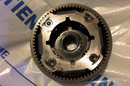

Minor setback with the transmission. One of the gears in the rear planetary apparently has been binding. You can tell which one in the picture, as that corner has turned blue from the heat. I did manage to get it freed up, but it now has a lot of play in it. It would probably work, but it is a lot noisier than the other three. Just to be safe, I ordered a replacement planetary set. I have enough other things to work on until the new gears arrive.

Yes, definitely replace... Keep turnin' those wrenches!

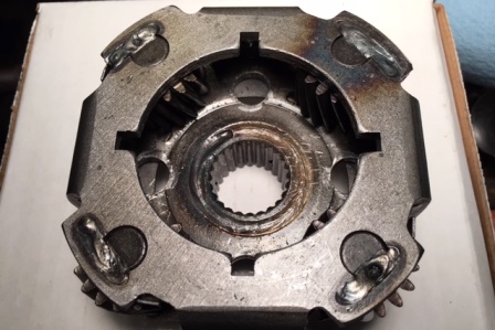

OK, now this part looks a LOT better.

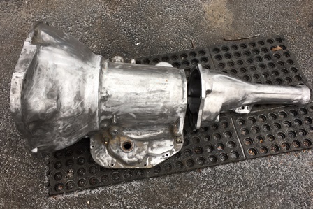

Transmission case is finished. Trans is now ready for reassembly. I hope to have this thing buttoned up by the weekend.

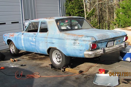

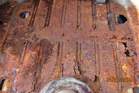

OK, moved the car over to the shop. Vacuumed the inside and trunk. Found some bad news in the trunk. Water leaked in and ruined what was left of the floor. Looks like I am giving AMD a call. The good news is that the interior floor, although also rusty, is solid enough for now. Just carpet and bolt the seats in.

Cut the floor out and weld in some braces for a fuel cell and rivet in a flat alum floor. You can run it like it is for M-D in a month. Just don't pop the trunk in tech...

I ordered the new AMD trunk floor (dang thing costs as much as the interior floor-oof!). It really shouldn't be too difficult to install. I was worried about tech, especially with the battery back there. So rather than chance it, I am replacing it. I need to find some sheet aluminum to place where the rear seat used to be. I am really hoping to get enough done to race it at Mason-Dixon in May. It won't be pretty and might have some duct tape here and there holding it together, but the plan is still M-D in May.
