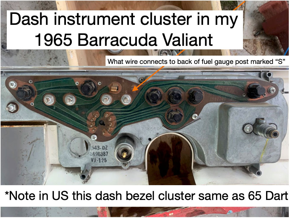

Hi Hoping someone can help.
I took my dash out to work on the fuel gauge. On the circuit board there was no wire connected to the "S" post. I've looked at the electrical diagrams, but can't figure out what wire connects to right side of the fuel gauge marked "S"
I've attached a picture.
File comment: What wire connects to the nut on the right side of the fuel gauge?

The 7805-based hack works, sort of, but is not wise. Get this IVR3 instead, and install it per these and these instructions.

I have the Part Dan Recommends in my 64 dart. I opened the VR contacts in the Fuel Gauge so they never touch.. Has been in there 3 years no problems so far.
Why is it not wise? As an electrical engineer I see no problems and have run with the 7805 for probably 10 years or more. The IVR3 you referenced costs $50 vs. less than $5 for the 7805, which will probably out-last the car if it has a proper heat sink.

Unwise for the same reason driving around with a single-pot master cylinder is unwise, or without a seatbelt: you can get away with it for a long time until you suddenly don't, then you might have time to wish you had chosen otherwise before very bad things happen. If a homemade 7805-based setup loses its ground, the gauges will quick-fry to a crackling, crunchy crisp. And even if it manages to keep its ground, that setup draws a lot of power and puts off a lot of heat.
I have no affiliation with the R/T Engineering people and it's no skin off my knuckle (nor any of my business or concern) what anyone chooses to do with their own instrument cluster, but there's a reason why the thoughtfully-designed, failsafe part costs more than the electronic hackquivalent of baling wire and chewing gum.
