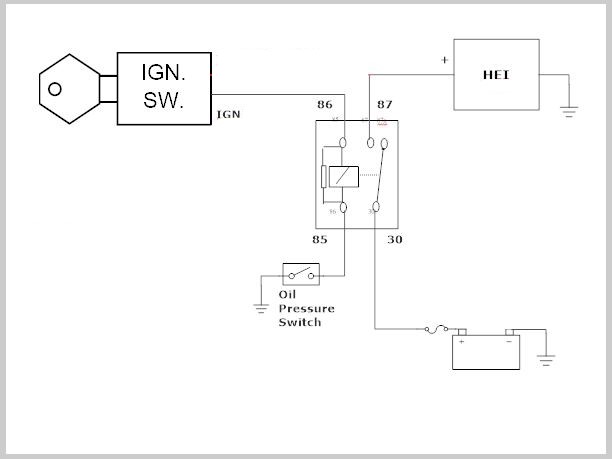

So in you setup Matt, the oil cut off switch is a normally open (pressure to close) switch? Correct? My MP one is a normally closed.
Your set up makes perfect sense and will eliminate the dead short I have created. :?
So my truck did not have any ballast resistor. What would I do with Ign.#2 in that case.

Yes, electronics are my trade. Drawing on the computer is not though so I can't easily create a diagram for you, but I think I can do one without going crazy. In fact I'll cheat and use MattMan's and go from there.
This diagram will get you an engine that only has ignition power when the ignition switch is on AND the oil pressure switch grounds the HEI relay. This is opposite operation of most oil pressure switches. With your existing ground-on-low-pressure switch the engine will only have ignition power with low oil pressure.

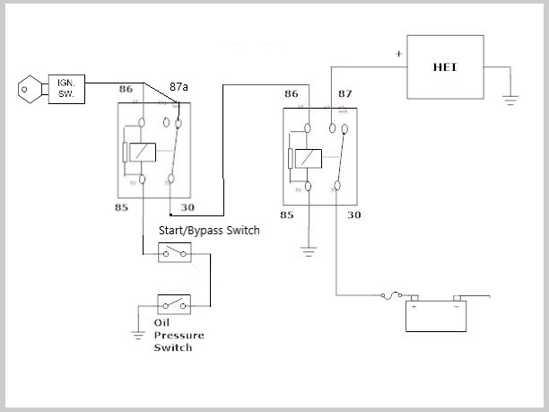

What do we do? Change the switch to one that opens on low pressure to de-energize the HEI relay or add a second relay as a cut-out. This is the second diagram. Cut-out relay is on the left. Circuit operation is like this... With the ignition switch on and bypass switch open the ignition will always have power through the cut-out relay's normally closed contacts. With the ignition on, bypass switch closed and the oil pressure switch closed the relay will energize and open the contacts killing control power to your HEI relay. Open the bypass switch or oil pressure switch the relay is de-energized and ignition switch power passes to the HEI relay.
Do I really need a second relay you might be asking? No, you don't. But that's another diagram, the circuit explanation is a little more complex and component selection becomes more important.
Honestly I would not have the ignition cut off by low oil pressure for safety reasons. What I would do is a warning buzzer like air-brake equipped vehicles are supposed to have. Low oil pressure would turn on the light and buzzer. The operator would then make the choice of whether or not to kill the engine.

Thanks Josh. I definitely do not want to have two relays or over complicate it. So one more question.
If I use Matt's drawing. Change my shut off switch to normally open. Could I not just manually ground the #85 wire before the switch just for start up?
