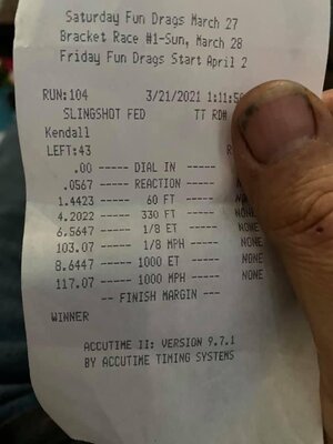

Jeff Kendall, our 2020 National Champion AND Rookie of the Year, just blew away his best time in his SDRA dragster.
He’s gonna put that AA/Gas record out of reach for us mere mortals.

No quarter mile time?

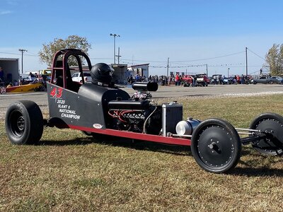

Can anyone post a picture of his 'car'?

PostPosted: Tue Mar 23, 2021 9:59 am

We were not running the quarter mile at the Spring Hot Rod Reunion, only 1000ft in Slingshot/FED class. The SDRA class also ran the 1000ft with a 9.50 second index. I took runner up in FED. I totally botched my dial and broke out in the finals.
I'm looking forward to meeting some new faces and having fun at the Mopars Invade at Mokan. I'm sure there will be some good racers and close races. I am NOT planning any crazy trips out east. So you Slant Six guys need to come to Mokan to get a jump start on your points lead for 2021!
So what did I do to the car over the winter to make such a big improvement? Basics! Basics! Basics!
The bores were not round or the right size for the pistons, so I got that fixed. The rings were Total Seal brand, but designed for a vacuum motor (ultra low tension, so says Total Seal) that were provided by the piston manufacture. So new rings that actually seal (Thanks Keith @ Total Seal). The exhaust valves had touched the pistons, and therefore were slightly bent, but not enough to keep it from running. So that was fixed. The intake was never ported, so I spent some time with the die grinder and stuff to get that all matched up. The stock head gasket that matched the bores perfectly before assembly, "squeezed" into the bore after torqueing the head bolts, and the fire rings were almost burned through, so a new overbore head gasket was installed. A new 8" torque converter from a well known Slant Six guy replaced the almost stock converter I used in 2020. And a major diet for the #43 for some weight savings. I hope to get some additional "improvements" completed by the Mokan meet, but work and such keeps getting in the way.
Ultimately the plan is get the car into the 9s. The chassis is certified. Once I get it into the 9s, the goal is to get my competition license. It may take putting it on Methanol and add a trans brake to get there.
Warning! I know some of you have probably done this before, but just so all you know I'm a real human and make mistakes. Always check for the cam plug before bolting up the transmission. Those that have made this mistake know how you find out!
Thank Rob for posting pictures.

Very exciting. Nice work on the basics and making a super nice combination of engine/drivetrain mods and car. Seems like you'll be well into the 9s with that 1000 ft ET!

At 2000 lbs, the ET computes to 350HP, the MPH to 340HP
All I can say is WOW! Just awesome.
What would you say is the weight of the car?
