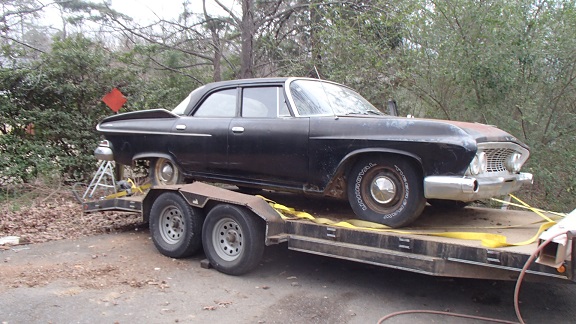

Hey from Arkansas. I just bought this 1 family owned '61 Seneca. /6, 3 onda tree. Luv your 2dr. I'm sorting out all the issues of mine since its been sitting since 1981. I found the original window sticker and build sheet to this car. Keep up the good work. Most of the guys on this forum don't drive these early model /6 cars.

Nice pick! These are cool cars and gives a very comfort ride.
