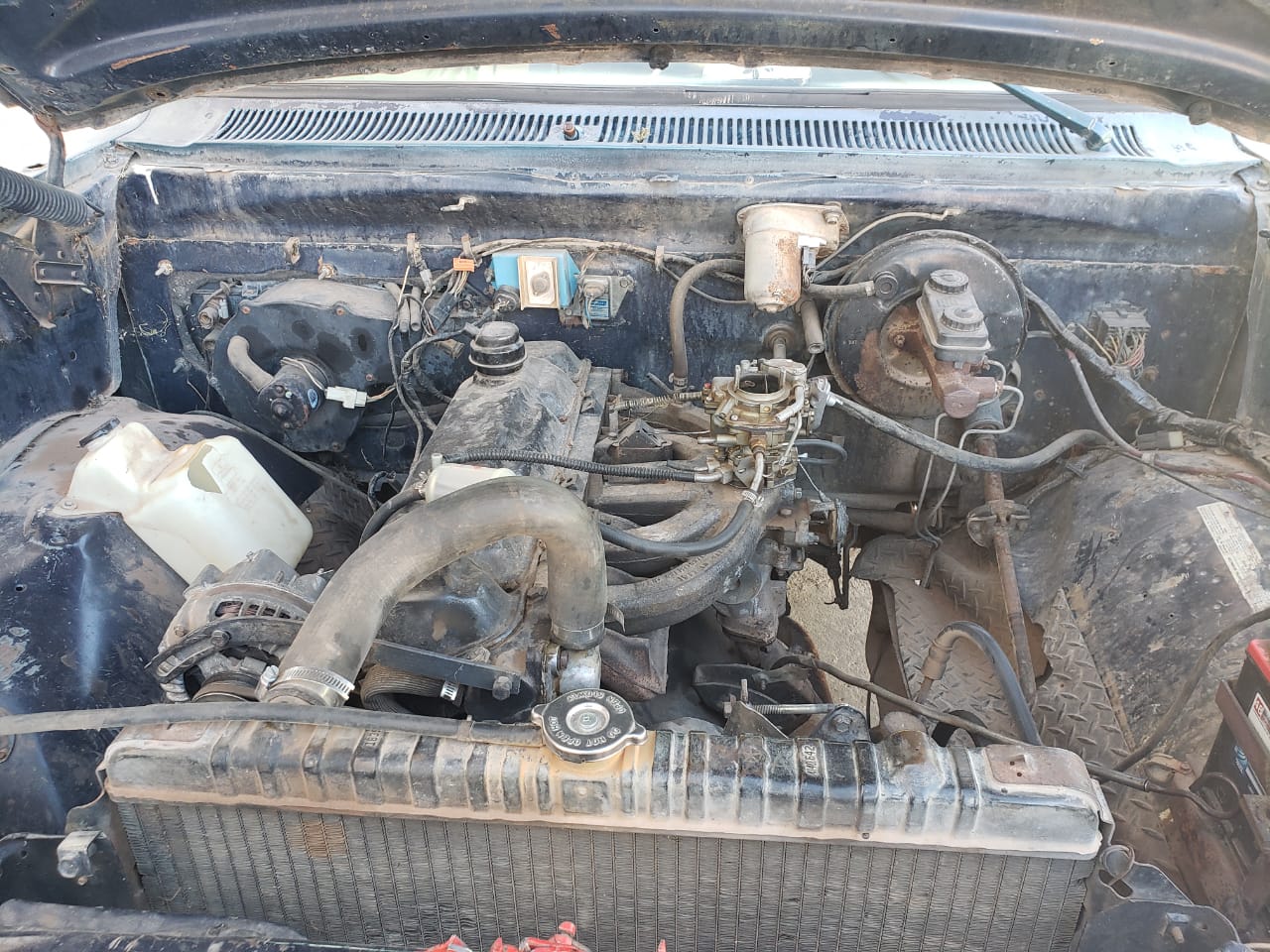

I'm I'm texas. I change the cap and rotor than. Gas and oil filter are new. Honestly and times it will start up great and drive no issues than just die while driving 10 minutes. Other times id drive it for 2 days with no issues. And like last night it wouldn't even start. It seems to take gas fine. What do you mean by it bogs out? Not sure if I have a lean ignition or if it's been converted ill send a picture to see of you can tell.
PostPosted: Wed Apr 06, 2022 5:55 am
Posts: 3048
It's been converted, see that blue box on the firewall? That's the ignition box

Only one bolt , ground is probably intermittent. Get some sand paper etc. Box needs good clean connection to sheet metal,its return path to battery . No ground no spark.

Aaa I see sand it down and find another bolt to bolt it in place. Could that really cause an issue
PostPosted: Thu Apr 07, 2022 12:12 pm
Posts: 1603
Could that really cause an issue. Yes in my opinion. Going on what you have stated and pictures. Ignition box ground is important.

I put a bolt in it. Still haveing issues. Do these rams have some sort of resistor on them? A mecanic friend of mine told me it was missing a resistor
