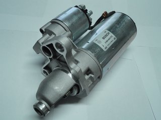

I first saw a starter like this a long time ago on eBay:
D_NQ_NP_2X_739961-MLM29748128352_032019-F-marcha-dodge-d600-1993-8-cil-59l.jpg [ 47.16 KiB | Viewed 12178 times ]
D_NQ_NP_2X_991600-MLM29748128353_032019-F-marcha-dodge-d600-1993-8-cil-59l.jpg [ 50.02 KiB | Viewed 12178 times ]
It was listed as a starter for a '95 Durango with 5.2 V8. Looked like a Bosch PMPGR starter as used on FWD 4-and 6-cylinder Chryslers from '86 to '95, Volvos from '86 or so on up, and numerous other applications. So I sez to my rotating-electrics guy – he's like me with car lights, but for starters and alternators – I sez, "Uhhhh…is that a Bosch PMPGR starter for '62-'02 Chrysler RWD‽"
And he goes "Uhhhh…yeah, it is! WTAF?"
Neither he nor I can find evidence of this starter's existence. None on eBay, none in pages and pages of results for starter searches on Hollanderparts and car-part.com, none in any-year factory parts cattledogs, none in aftermarket cattledogs, not even a mention of it on RockAuto, just nothing. Best either of us can come up with is a faint hint of a reman-industry number, which nobody ever seems to have cattledogged or stocked. No bill of materials, no applications, no nothing, and always with a redirect to the (Nippon)Denso PMGR starter everybody already knows about, the kind factory-installed starting in '88 when they quit using the Chrysler-built OSGR starter.
Eventually I figure this is just another piece of evidence that a squirrel or something got into one of those particle colliders while it was running and shunted us all into »gestures at everything« this, and I'd seen a starter from another timeline. Either that, or a glitch in the matrix.
Still, it kept nagging at me. The pics in the eBay listing were real ones, not drawings or renderings. Things like this are like loose teeth to me, or ravelling threads: I cannot resist picking at them.

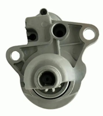

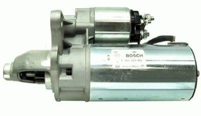

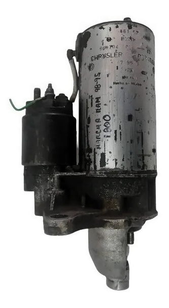

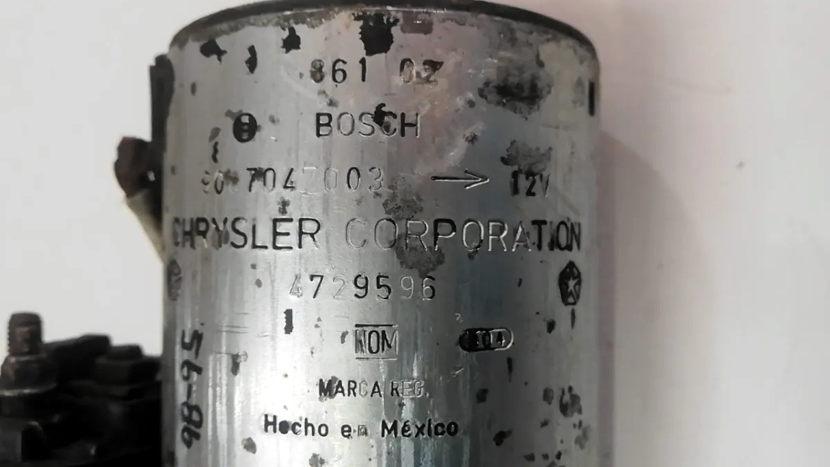

Just shortly ago, instead of working on a project with a looming deadline (it's looming even larger now) I picked at this mystery again. Don't recall what subchamber of a late-night rabbit hole I was in when I stumbled onto the actual story of this starter: it was used as original equipment in Mexico on at least '94ish to '98ish Dodge Ram trucks and vans with 3.9 V6s and 5.2 and 5.9 V8s. Locally made by Bosch in Mexico:
I didn't like giving up my alternate-timeline explanation, which was kind of giving me hope.
So I went digging further, and found some OE Bosch numbers, donned my virtual hip waders and went sloshing through AliExpress, and there I found – just imagine my shock and surprise – that new starters of this type are being made in China. On that subject, my rotating-electrics guy says "They've figured out proper metallurgy and surface treatment, so their starters and alternators are a whole lot better than they used to be; generally they're fine".

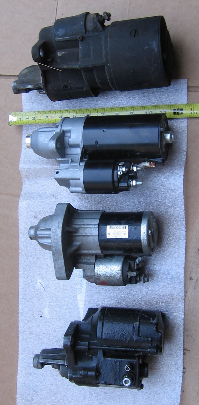

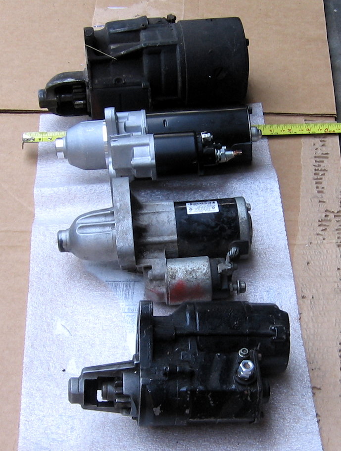

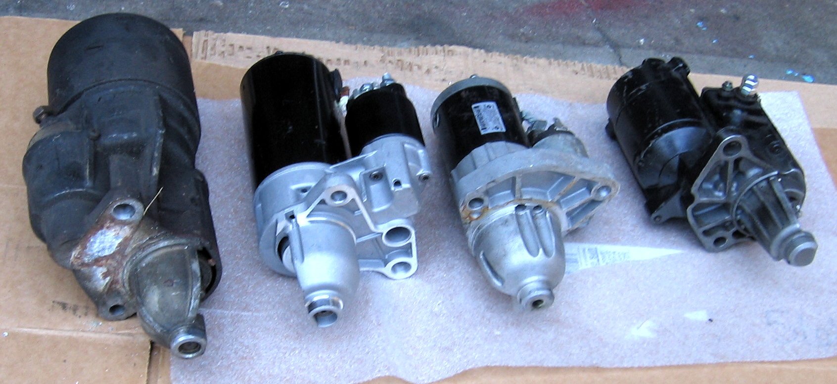

Its main body is ~same diameter than the other starters, and slightly longer than the 56029274AA '05-'08 Ram Hemi/MT starter made by Mitsubishi (not as much longer as it looks; the different division between steel motor frame and aluminum front casting creates the illusion of much longer). Its solenoid is clocked such that on a Slant-6 it protrudes outboard more than the block-hugging one on the Ram Hemi starter. Cranking speed (i.e., starter torque) is audibly higher than any other starter I'm aware of that'll fit a Slant-6; the nominal rating is 1.8 kW, which is a whomping 2.4+ horsepower. Compare the first-design Chrysler geared starter (1.3 hp), the second design (1.5 hp) and the extra-big 3rd design (1.8 hp), and the Nippon/Denso at 1.9 hp. The Hemi/MT item is 1.7 kW (just under 2.3 hp). So you're gonna win the starter-horsepower bench race every time. :mrgreen: Other than bragging rights, this kind of extreme starter power is unlikely to be actually needed on a Slant-6 application; for high-compression V8s I can see it being a real nice alternative to spending hundreds of dollars on an aftermarket hot rod starter (Powermaster, etc).
One advantage of this starter over the Hemi Ram item is that it just bolts right on. Drop in and go. You don't have to drill out threaded holes or buy a special countersink bolt as the Hemi Ram starter requires.
Should you buy one? Well…h'm. Do you want one? :lol: Here it is at a friendly price (and for what it's worth, Amminazon thinks it weighs 9 pounds, 5 ounces).
Pics (Chrysler, Bosch, Mitsubishi, Nippon/Denso):

Thanks very much for the info, Dan. Might try one! I am always futzing with different transmissions/adapters and exhaust systems, so it might come in handy. I have 6 speeds and boost and a different chassis on my mind for the future... I feel like this new one could allow more space for exhaust coming out of a rear Dutra manifold? Will ponder.

I does look like it may give a little more room for Dutras at the rear?
