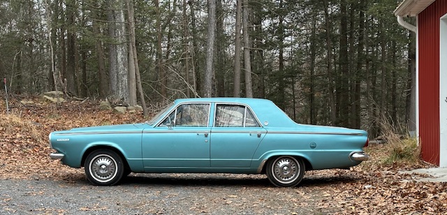

Here are my measurements, on the very smooth, level concrete surface of my shop, unloaded, with a very empty gas tank, riding on B78/13 bias-ply tires inflated to the specified pressure (24psi, if I recall):
LF: 8-1/8" RF: 8-1/8"
LR: 9" RR: 8-1/2"
And here is a photo of my car from the side. The surface it's on begins to slant uphill slightly at the front.
Thanks for anything you can tell me,

60 year old rear springs will be sagging and fatigued, just how much is hard to say, the rear spring bushings are probably perished as well.

Can't tell from the photo. Looking under the car at the spring's arch is it humped up, straight, or down? Humped up or straight indicates a sagging spring. Measure the distance to level floor from each end of the pinch weld under the rocker panels. Those four measurements should be close once you follow the ride height adjustment measurements listed in the FSM.
As I said in my first post, just above the photo:
LR: 9" RR: 8-1/2"
Height to the rear rockers is just the tiniest bit higher in the rear than in the front.

CONCLUSION:
I answered my own question.
In the 1964 Valiant AMA Specifications, page 24, are listed height from floor to bottoms of rockers and floot to bottoms of rear edges of doors.
It's not for the Dart, but the Dart can't be very much different.
Specifications (with 300# Front Seat, 450# Rear Seat, Full Gas Tank) are:
  • Front Rocker to Ground..........7.4"
    Rear Rocker to Ground...........7.0"
    Front Door to Ground...........11.7"
    Rear Door to Ground............11.6"
My car (empty) measures:
  • Front Rocker to Ground.............8.125"
    Rear Rocker to Ground..............9"L........8.5"R
    Front Door to Ground.............12.5"L....12.125"R
    Rear Door to Ground..............13"L.......12.375"R
So, if I get a chance to load up my car, I can tell for sure, but odds are it's a bit low, but not so severely low that I need to address it immediately.
