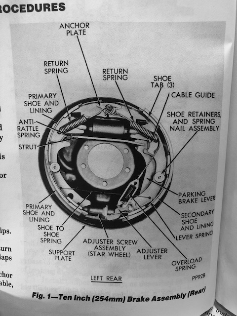

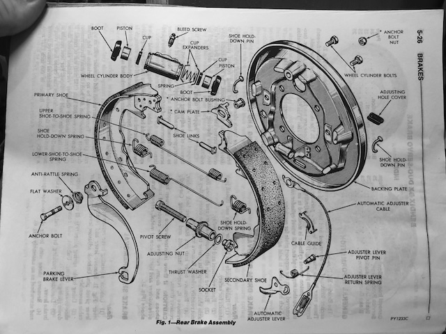

Direct from my 1983 truck/van factory service manual.

Just for clarification, those pictures show two different type brake assemblies
PostPosted: Tue Mar 04, 2025 3:43 pm
Posts: 13264
Yes, sorry, I should have clarified. The exploded view is the Bendix brake assembly, the assembled view is the factory Chrysler 10 inch brakes. Those were the only diagrams I could find in the drum brake section of my 1983 FSM.
However, basic drum brakes parts and assembly are largely the same. Short shoe goes to the front of the vehicle.

The first picture is the one. My truck for whatever reason is missing those parking brake levers
