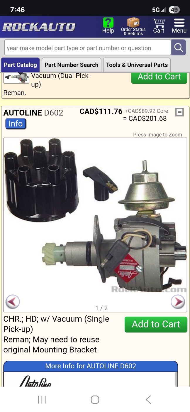

    I hope this works but I have just posted a picture of the distributor that I want to use can anyone tell me if it'll work good or I can use it for the hei set up/conversation? And or does anyone have a good use one they'd like to get rid of?

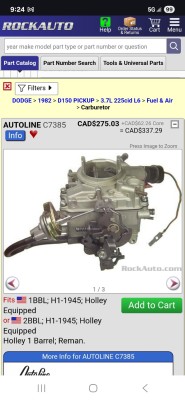

    And now I have posted a picture of this carberator that I had bought and replaced my old one with an thats when everything shut down on me,
    Can anyone tell me if I do the HEI conversation will this carberator work for this set up? Still even if I get rid of the lean burn? Thanks

    without commenting on the quality of today's remanufactured parts. yes the distributor is what you are after, with or without doing the hei conversion.
    you may have trouble with the carb, do to the fuel control solenoid no longer being used.
    personally i would make the salvage yard pilgramage and get all the needed parts from a none lean burn slant 6 1barrel vehicle. that would also allow you to get the harness assembly complete.

    Okay can I not just hook a 12v power up to the fuel solenoid and still use it, or why would i not be using it anymore? Is there any way I can use it other wise, if anyone else knows about this? As I just bought it brand new.
    And okay then ill use the same kind of distributor then, ill go to my junk yard an see what I can find
