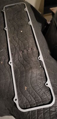

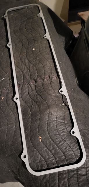

Hey Guys:
Sorry it took so long, was swamped with work, had two B-day parties to attend, and found out a good friend died suddenly on Tuesday. Just wasn't in the mood to sit at the computer and post.
I got the first prototype cut last Saturday out of 3mm cardboard(1/8" in the cardboard world), Anyway, I had an audience of good friends visiting from out of town, so of course, the laser started acting up. For some reason it would start each cut fine, but by the time the beam had traveled 30" or so, it would stop cutting through the material and the beam width had doubled in Kerf. I was able to Exacto knife the uncut areas, hence some ugly edges in the pictures here and there.
I'm figuring the X-axis mirror has come out of alignment, so the farther you travel in X, the worse the problem and cut. It's a 20yr old Beam Dynamics 500W, and usually we can cut up to 1/8" steel, albeit slow, about 4"/min. Anyway, I'll figure it out, since it's my job to fix everything...and I've been fixing this laser for fifteen years.
Here is a couple of pictures. I got all the measurements correct except the end raius'. I thought it looked/measured 1.125" radius, but it must be 1.25 or 1.375" to pull in the corner.
I'll post a revised drawing and CAD files for cutting after I fix the drawing corner radius and the laser, so I can cut another prototype.
Remember, this file would work great as a valve cover rocker clearance spacer, but would need to be modified to work well to make gaskets. When I have a clean valve cover in hand(soon), I'll create that drawing as well.
Thanks

Just had a crazy busy week as is the self employed lifestyle.. I bolted the gasket down to get the most accurate measurements I could. I need another 1/16" on one side, and a minor tweak on the radius on one corner. The drawing is easy enough to change, however, the laser cutter now needs maintenance, which I have very little time to provide. I have full access to the laser cutter, but I contract my work to the facility, and other work is keeping me away from the laser cutter. As many who have read my various threads on this site, my life is not predictable, and it is difficult to predict tomorrow. I will try to fix the laser problems this week, then cut a template, and if it fits, provide .dxf and .dwg for laser or water jet cutting.
