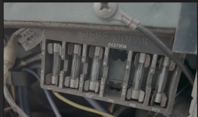

I need to put in a new "holder/bracket" for my accessory fuse in this fuse block. Not sure how the old one fell out but there I am.
Not sure if I need to remove the fuse block to do this, or just get a replacement holder and snap it in.
I've easily sourced the fuses but can't find anything resembling the bracket / holder. I could hit a salvage yard near me (Portland OR) if this is the kind of thing I could pull from an old car.
Thanks for the guidance!

Was there ever a fuse in that slot?
Was your car made with any electrical accessories, other than the radio and heater?
What year and model is it?

Often the factory fuse boxes have one or more slot with no bracket (ever). Those would have been for extra optional accessories.

I would just add an inline fuse.

here y'go, nice shiny new fuseblock clips.
