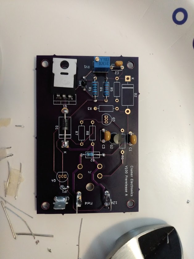

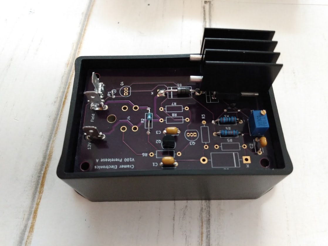

The parts are trickling in. At this point I can assemble enough of one to give you an idea of what the spade terminal version will look like. Finished prototypes will be potted in clear silicone.
File comment: Partially assembled
File comment: Bare PCB

After several false starts (including something sold as potting compound that was definitely an industrial caulk tube), I was able to run one on my car for about 20 minutes.
Next step is going to be to lay out a production circuit board - and this one will use a stock-fit connector.
