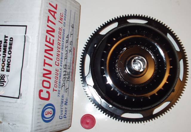

The stock torque converter is a 10.5 inch, they stall around 2500-2700 if you have a "high stall" version.
A smaller converter (8 or 9 inch) is a custom converter, the one I have stalls around 3800 and it is pretty efficiant, here is what it looks like:
http://www.dutra.org/pictures/parts/tra ... verter.jpg

Thanks for the information on the convertor. Where do you buy this brand and how much are they? I have read about some for the 727 trans but I have not located any for the 904.
Since the engine I am using is not fresh(probably a little weak) I am wondering if the stock stall might be enough for now. If I have to buy one I would buy a higher stall but since I think the one currently in the car is okay, I might just keep it.

Doc, I don't mean to be picky, but the box in the picture says 9" not 8" ?

Good catch, that was the only pic I had "handy". :wink:

:D Hey Doc! Being a drag racer S/G&S/ST(I don't race my /6 car's"yet") i gotta say i am impressed with your converter selection. I have known Cris at continental for 20 years and even before he became the owner he made the best converters money can buy! I had one in my challenger from the mid 80's to last year with a brake!! As you know being a racer, that is unreal!!Juat wanted to tell ya Doc, I am impressed and you got my vote Man! Good luck in Vegas.............Bill

Yes, Cris at Continental does make a darn good converter. :D
