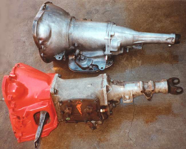

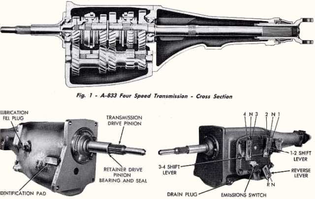

How 833 Four Speeds Differ
There
are several characteristics of the various A-833s that determine

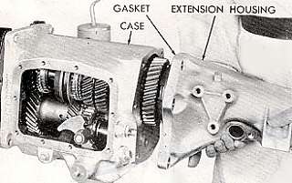

which four speeds fit in which chassis and with which engines. For

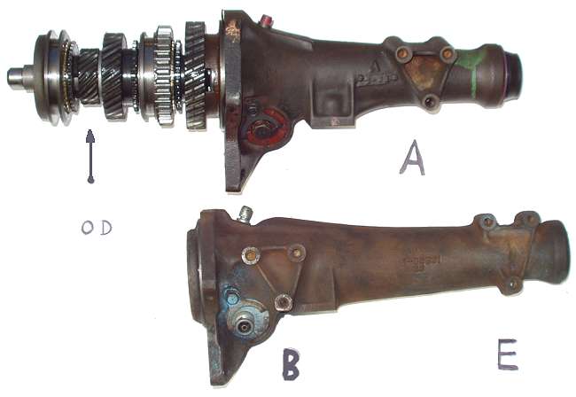

the passenger cars, Chrysler manufactured two different length four
speeds. The A/F-bodies received a short tailshaft A-833 and the
B/C/E-bodies received a long tailshaft A-833. This difference is
obvious when one of each type is sitting side by side, but either
type is easily identified when it happens to be a stand alone unit.

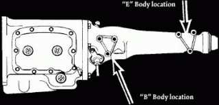

The short A/F-body tailshaft places the shifter pad behind the cross
member mounting
flange.
(The "shifter pad" is the 3 bolt bosses set in a triangle shaped
pattern on the side of the tailshaft and servers as the mount point
for the shifter). The "cross member mount flange" is the 2 bolt pad
on the bottom of the tailshaft that servers as a mount point for the
cross member). A/F-body 4 speeds have only one shifter pad. The
1964-1969 B/C-body A-833s place the shifter pad ahead of the cross
member mount flange, and the 1970-74 B/E-body "long tail housing"
four speed has two shifter pads, one ahead of the cross member mount
flange (for B-bodies), and one behind the the cross member mount
flange at the very end of the longer B/E tailshaft housing (this
position is used in E-bodies).

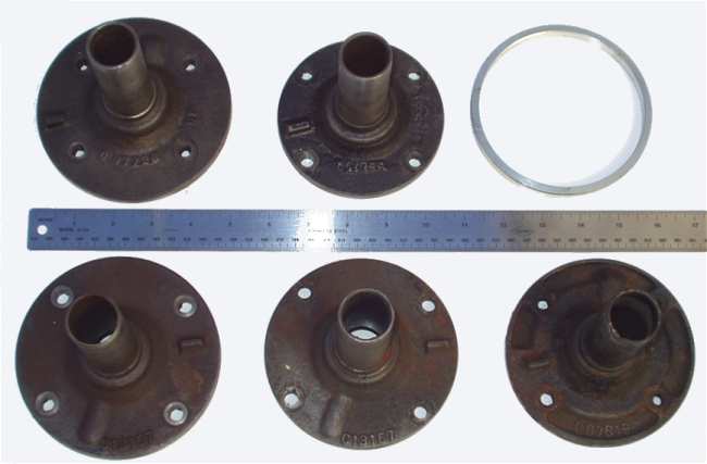

tranny swap. Perhaps the most troubling is the diameter of the Input
Bearing Retainer (or IBR) that is located on the front of the four
speed and fits into the large hole in the back of the bell housing.
There were three different sizes on production four speeds. There was
the 5.125" dia. IBR used on the 1975 and later Overdrive units, the
4.80" dia IBR used on "Hemi" transmissions, and a 4.35" dia. IBR used
on everything else. The 4.80" IBR "Hemi" units are also known for
their special "course cut" gears, 18-spline input shaft (or "Main
Gear Drive" as it is referred to in parts manuals and FSMs), larger
input bearing, and the requirement of a larger clutch release
bearing. Calling it a "Hemi" unit is not entirely correct, the 18
spline units were also used in most 440 applications as well. "Hemi"
units are rare compared to the regular 23 spline four speeds, however
there are generally a few floating around at most major swap meets
(bring your check book).

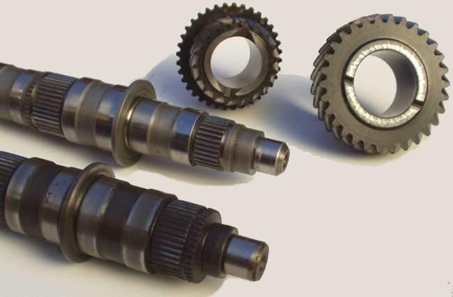

The
Overdrive four speed was a regular A-833 with an overdriven gear set
installed in place of the regular third gear. The shift lever on the
side cover was flipped over to "fool" the shifter into shifting from
second to fourth and then back into third, which was the overdrive
gear. The overdrive gear is very small and as a result, the mainshaft
journal and splined hub is smaller. You can swap OD 833 parts as
a set into the correct case for the mainshaft.

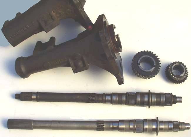

Chrysler engineers decided that Hemis required a beefier input shaft so the standard 23-spline shaft was replaced with a beefier 18-spline unit and a larger input bearing was used to accept the additional torque. Later Chrysler decided that the high performance 440s needed this beefiness as well. It is one of a few aspects that set the "Hemi" four speeds apart from the standard 4.35" A-833s as being extra beefy. As far as strength is concerned, outside of the input shaft, the input bearing, the retainer and some special gear sets, there were no additional measures added to A-833s for Hemis. In the Sixties the only other difference between a Hemi A-833 and a Slant Six A-833 were the gear ratios used. The Slant Six 4-speed is just as beefy as the Street "Max Wedge" V-8 units.
The
Overdrive 833s used a giant 5.125" IBR and the super large input
bearing behind the IBR as sort of a reinforcement measure. Most

A much cheaper and plentiful bell housing to use is the 1975-81 A-833 Overdrive Slant Six bell housing. The upshot of this bell housing is that it is cast aluminum, the downside is that it only accepts A-833s with 5.125" IBR profiles. When looking for donor vehicles in salvage yards, don't' walk past late seventies slant six three speed cars. Chrysler used the same bell housing for both A-833 Overdrives and three speeds by placing both bolt patterns on the same bell housing. A casting number for this bell housing is 3743645. (This is a 1975 number, no doubt later bell housings used other numbers.) The Overdrive bell housings use a unique clutch fork mount that you will not find on regular three speed or four speed bell housings. Make sure you keep track of the correct fork and its mounting stand that bolts inside of the bell housing!
The
Overdrive bell housings can be modified to accept either the 4.80" or
the 4.35" IBR. A ring must be fitted to the bell housing to reduce
its IBR hole from 5.125" to 4.35" or 4.80". This ring must maintain
the hole's exact center! A skilled and caring machinist should be
able to accomplish this without issue. Good planning would provide
the machinist with the bell housing and IBR you plan to use so a
perfect fit can be achieved.

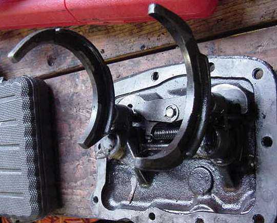

Shifters, Shift Rods, and Floor Humps
All
Chrysler A-833s were equipped with Hurst shifters with the exception
of the Inland shifter debacle of 1966-1968. The Inlands are pretty
recognizable (they don't look like Hurst shifters!) and I believe the
Inland-Chrysler relationship was rekindled in the Seventies with the
Chrysler floor shift A-body and E-body three speeds. A nice feature
of an Inland shifter is that it has a pull-up reverse lockout lever.
Enough talk about Inland, the Hurst units are the ones to have! There
was a huge variety of OEM Hurst shifters built and Hurst is still
happy to fix you up with anything you need from shift rods to new
shifters.

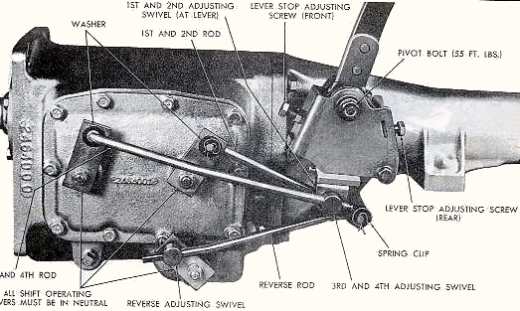

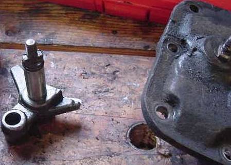

It
is important to point out that there is a shifter mounting plate or
"adapter" which goes between the transmission's 3 bolt shifter mount
and the 2 hole shifter "box". There are many different adapter plates
used for different chassis. The shifter adapter plate will angle the
shifter lever and has an effect on shift rod lengths. There are many
variations over the years and needless to say, you need the right
ones for your setup. Shifter linkage rod length changed between the
different platforms (A, B/C, and E bodies) as the adapter plate /
shifter was placed at different locations along the tailshaft.
Additionally, the A-body Overdrive A-833s used a different 3rd-4th
rod to accommodate the up-side-down shift operating lever. On top of
all that, the hole in the lever that the linkage rods fit into
changed in diameter at some point during the four speed shifter
years.
(Needless to say that it is best to get your shifter as a complete
set of parts and from the same year chassis you are working
with.)

If the donor vehicle (truck) has an 833 4 speed, it's a long tailshaft 833 unit and it won't really directly bolt into an A-body. It could be made to fit, but it would require some significant modifications. A long tailshaft 4 speed in an A-body will place the front B-Body location shifter directly in the path of the upper trans. torsion bar cross member section that goes up and over the trans and joins the the two t-bar mounting frame rails. You'd have to cut the cross member and either try to build a second one behind or ahead of the old one, or drive without one (not advised at all!). Another option is available if the long truck tail housing has the "dual location" shifter mounting pads use for the B & E Body. If so equipped, you can make up a plate that spans across the two shifter mount positions and then mount your shifter along that "adapter plate". Below is more detail on that swap, it has been done. It might still be worth while to grab the long tailshaft OD 4-speed if the price is right and then sell or trade it to raise funds for the proper A/F body unit. The A/F OD 833 is much more common than the B/E/truck 4 speed.
Adapting a Long Tail housing B/E Body Trans to the A-Body by Dave Clement
When I swapped from the 3 speed column shift in my 68 Barracuda to the long tailshaft 833 OD 4-speed from a D100 truck, the only fabricating I had to do (besides the tunnel extension) was to make a mounting plate that positioned the shifter forward from the rear shifter mount and shorten the drive shaft. Here are the things I found out about this conversion:
1. The three speed bell housing in my 68 Barracuda did not have the correct bolt pattern for the 4-speed and the bearing support pilot hole was to small. I used the bell housing from the pickup.

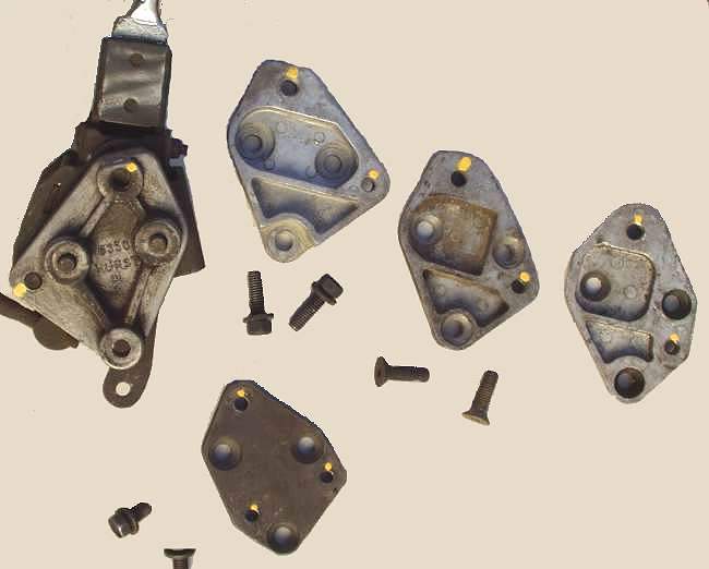

2. The 3 speed's rear tranny mount transferred directly to the OD 4 speed and mounted up with no modifications to the cross member. The distance from the face of the tranny to the center line of the tranny mount was the same for both the 3 speed and 4 speed and the distance down from the centerline of the output shaft to the face of the tranny mount were the same. I read that early B-bodies did have tranny mounts in a different location. Later, all trannies used the tranny mounts in the same position.
3. The z-bar pivot on the 3 speed bell housing transferred directly to the 4 speed bell housing. The truck pivot was longer and in a different position but its mounting pad is in the same location.
4. I had to use the truck clutch fork because its pivot in the bell housing was a ball on the truck and a bracket in the 3 speed and they were not interchangeable (bracket bolts on with two screws; the ball pivot is a single thread-in post). The extra 1" length on the truck clutch fork does not interfere or cause any problems. I am running 6 into 2 headers with this setup.
5. The front boss on the front shifter pad on the OD 4 speed interferes with the A-body torsion bar cross member. You can either dent the cross member or do as I did and cut the boss off the trans. tail housing.
6. The output shaft on the 3 speed is smaller than the 4 speed. You will need a slip yoke from either a 4 speed or 727 car with a universal joint size that matches your drive shaft (or get a crossover "problem solver" universal joint).
7. I forget the actual dimension but I had to shorten the drive shaft about 3 3/8". (Measure everything once the setup is in the vehicle and resting on the ground at ride height.)
8. I used standard 4 speed A-Body shifter rods. The flipped over 3/4 lever puts the rod close to the cross member but since I was fabricating a mounting plate anyway I made sure that I had enough clearance before drilling the shifter mounting holes in the new plate. I used the standard A-Body shift mounting plate (adapter) along with about 1/2" of spacers on my fabricated mounting plate to locate the shifter towards the left so it came through the floor in the correct position, closer to the driver.
9. The shifter mechanism that was on the truck was made by Hurst and looked just like a Competition Plus shifter without the adjustable stops and had the bayonet attachment for the shifter handle. I used this shifter with a handle off an old 3 speed shifter. I did have to ream out one hole on the shifter and one of the tranny levers to get the A-Body linkage rods to fit.

Conversion info on installing an 833 4-Speed on a 66 A-Body
Let's say you find an A/F Body OD 833 to install in your early A-Body. Here is the lowdown on how to install it into a 66 A-Body: Your 66 drive shaft will work as long as you have the proper slip yoke for the trans. (The slid-in yoke started in 66, earlier cars with the ball & trunion setup need the earlier trans or a different drive shaft and speedo drive setup.) You'll need a 75-80 \6 3 speed/4 speed bell housing (BH), dust shield and inspection plate along with the matching clutch fork. (Note the OD BH clutch fork is the long one that was also used on LA V8s. and not the smaller \6 fork used on sixties G/RG 3 speeds and 4 speeds.) You'll also need the right flywheel to mate to your SL6 crank. If nothing else I can tell you that your 75 crank will not work with a 67 or earlier flywheel (center register is smaller). The A/F body G/RG BH requires a smaller 124 tooth flywheel that was used on all passenger car \6 3 speeds and 4 speeds. The truck "granny low" BH used a larger 143 tooth flywheel.
If you are currently running an automatic, you need a 63-66 A-body clutch pedal setup, your crankshaft needs a pilot bushing, and you need to cut a big hole in the floor to accommodate the 4 speed shifter and shift rods. Of course, you'll need to cover this hole. The 4 speed hump to use is the 64-66 4 speed A-body hump which can be somewhat elusive, but not impossible to find. (There was one at Carlisle last week for $85, Brewers used to produce fiberglass repros, and I've seen 3 factory humps in junkyards in the last 3-4 years.) It doesn't have to be an original hump, you can fabricate a suitable cover out of sheet metal. You will also need a 63-66 3 speed/4 speed z-bar (torque shaft) and mounting brackets. By the way, if you had gone to Carlisle (or other big Mopar swap meets) with the idea of collecting all the required parts to "OD-4spd-ize" an A-body, you could have done it for anywhere from $200 to $500 for everything. You just need to know what you are looking for and as always, hope that the trans itself is in good working condition. (If the trans. needs rebuilding, see below.)

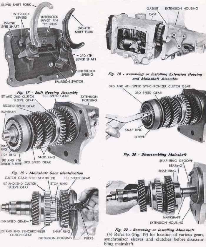

Special tip: On an OD 833, never slide the front synchro clutch sleeve (shift fork collar) "rearward" to engage the OD synchro and gear. The OD gear is so small that it will not stop the sleeve's travel so it will overextend and allow the spring loaded clutch struts to pop out of position. (These struts can be reinserted but it is a lot of extra work, especially on an assembled tranny.
With the mainshaft parts all assembled, tail extension housing installed and the reverse gear idler removed from the case:

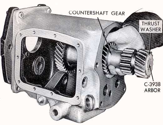

1)
Assemble countershaft cluster gear bearing set (needle bearings and
washers) using heavy grease to hold them in place. Cut off a broom
handle or rod stock of similar diameter to the countershaft itself
but 1/4" less than the length and insert this "dummy shaft" into the
cluster gear, in place of the countershaft. This will keep your
needle bearings and washers in place during the assembly process.
2) Insert the countershaft thrust washers into keyed case slots and stick them down with a glob of sticky grease.
3) Insert the countershaft gear cluster from the rear and leave it loose in the bottom of the case. Keep it stable with one hand if you move the case around or change the case's orientation.
4) Make sure the input shaft needle bearings are seated and stuck down with grease to the inside of the Drive Pinion gear. Double check their proper placement. With the #308 bearing installed, insert the drive pinion through the front of the case until seated. You can then install the drive pinion retainer with its seal and gasket (sometimes called the pilot retainer or input bearing retainer).
A 1 hole will need to be drilled into your bench for the next step. A custom stand with a piece of 1 ¼ pipe standing up to hold the tranny nose down will also work.
5) Tip case on its face, inserting the input shaft/bearing retainer into the hole. (This is where a friends help is needed.) Have your friend insert the mainshaft/tailshaft assembly into the butt of the tranny case (don't forget the tail housing gasket), while you guide the assembly, making sure you dont lose your struts/shift rings/synchros. Rest the nose of the mainshaft on the outer edge of the drive pinion for a "rest stop". Now make sure you havent lost any of the shift rings and struts. Also make sure your 3rd gear (front) synchro is in place. Now move the mainshaft assembly to install it into the roller bearings of the drive pinion. It should drop in and mate together with little resistance.
6) Twist the tailshaft housing until it clears the countershaft hole, then insert one bolt to hold it in place.
7) Line up the countershaft gear cluster with the holes in the case (make sure your thrust washers are still in place and aligned properly with the case holes). Your piece of broomstick will start to come out if aligned correctly. Grease up the countershaft and drive it in from the backside. The broomstick will fall out the bottom, leaving the needle bearings in position and the countershaft installed (make sure to line up the small woodruff key in the shaft and case before driving it home the last ½).
9) Put tranny on its belly. Remove tailshaft housing bolt. Twist the housing 30 degrees the other direction to clear reverse idler gear/selector shaft hole, and insert your keeper bolt again in the most available hole.

Replace the o-ring seals on shift levers in side cover/plate. Check
for the special shoulder screws and note the proper holes they go in.
(One may extend through the cover plate and into a counter bored hole
in the case, mark that bolt and hole).

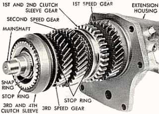

Now the fun starts. Get another person to help during this next step. It is a "4 hand job".
You need to lower 50 pounds of gear/mainshaft /tail housing assembly into the case. Before you start, be sure the tailshaft gasket is in place. (I put a little glue on it to keep it in position.) Now slowly lower the tailshaft/ mainshaft assy in, snake around the reverse idler and countershaft gears. I shoot to rest the mainshaft "nose" on the edge of the input shaft "cup" as a "first stop" to give my arms a rest and to check my "indexing". If the collar slips-off, pull the assy back out and reset the collar & toggles.
Position the synchro and collar so your paint marks are lined up.
Move the assembly in to stick the mainshaft nose into the needle
bearings, as your assistant makes sure all the other gear cogs "mesh"
with the countershaft teeth. (Rotate the cogs on the mainshaft, don't
turn the input / countershaft because that throws off your paint mark
alignment.)
If you get all this stuff lined-up correctly, the whole assy just
"plops-together", without much fan-fair and you are done.

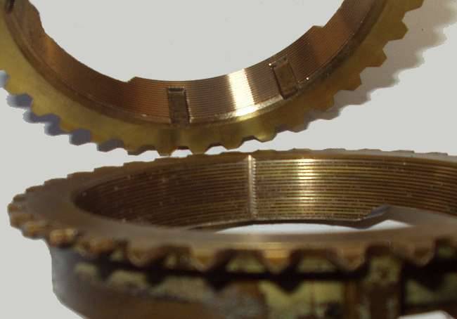

Some brands of brass synchro rings (stop rings) have oil relief grooves cast into them. These help channel the oil out of the friction surface for a faster grip and shifts, especially when the oil is thick and / or cold. (grooves can also be added but stay away from notches or thin sections in the stop ring, they can crack along any thin spot or added groove.
Always check the front ball bearing snap ring thickness to be sure it fits into the shallow counter bore in the front Input Bearing Retainer (IBR). Some snap rings are too thick and / or wide and will not allow the IBR to seat and seal on the gasket.
Inspect and deburr (file smooth) the teeth of the slider clutch hubs. (the hub where the "toggle struts" mount)

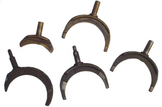

On
early "flange type" 833, the 1st / 2nd shift fork is a "stubby" brass
piece. Replace it with the later "wrap-around" fork for better
shifting. Wrap around forks with the extra length thin extension on
the end will need this extra length cut off.
On later side covers with the stamped steel internal levers, it can be a challenge to install the 1st / 2nd "wrap around" shift fork. On way to do this is to place the 3rd / 4th fork into the cover and then loop a flexible wire around the rear section of the levers, to allow the cover to drop onto the second lever. Once the cover is on the lever, the wire can be pulled-out. Another option is to leave the back-up light switch out and stick a thin probe through that hole to help align the fork to the cover lever detents.
Pay special attention to the front of the cluster gear counter shaft where it extends through the case. Seal this area carefully because it is a source of leaks. The side cover levers and the reverse light switch are other leak points to reseal. (new "O" rings and reverse switch or case plug)
