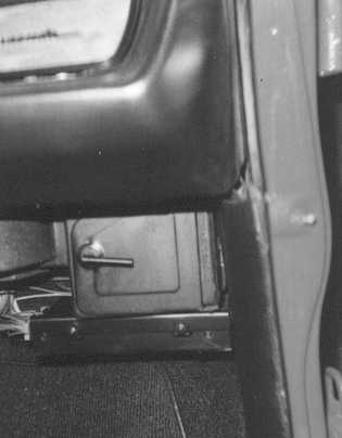

The ECM is not designed to be mounted in an engine compartment
environment. So, one of the first decisions youll have to make
is where to mount the ECM in the passenger compartment. I fabricated
a bracket from angle
aluminum
and mounted mine under the passenger side vent door. The firewall,
just to the left of the vent door, provides a good location for
drilling the hole to pass the wire harness through. As you will see
by the size of the wire harness, the hole will have to be about an
inch in diameter. I used (and ruined!) a hole saw to make this hole.

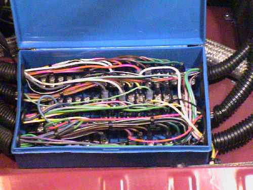

I
found that the best way to splice and organize the wiring harness,
between the ECM and everything else, was to use double row terminal
strips. These are placed in a plastic crayon box (Wal-Mart, or steal
it from your kid!) and mounted under the hood on the inner fender.
This "junction box" provides a convenient location for tapping into
the circuits to monitor the electronics and for future
troubleshooting. The box also provides some protection from dirt for

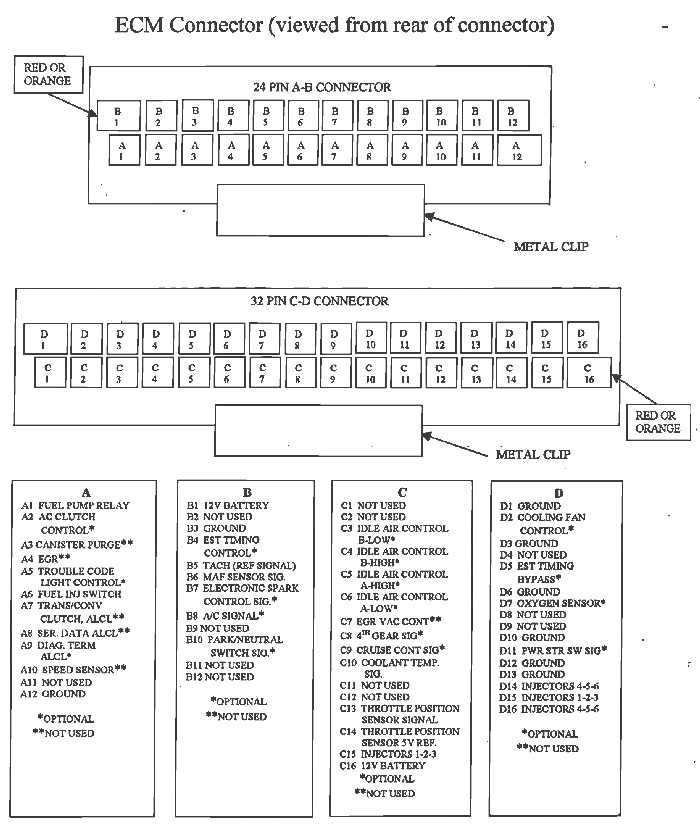

the terminal strips. You will need four terminal strips to organize
all of the wires that go to the 24 pin A-B and 32 pin C-D connectors
located on the ECM, two strips with 12 positions each, and two strips
with 16 positions each. The terminal strips can be configured to the
same layout as the plugs at the ECM and makes it easy to keep track
of the different circuits. See the ECM
connector drawing and the wiring
diagram for the correct layout. This arrangement will give you
much better access to these circuits than Mr. Goodwrench ever dreamed
of! There are also two additional 3-position terminal strips that are
used. These are for the three weather tight fuse holders shown in the
wiring diagram.

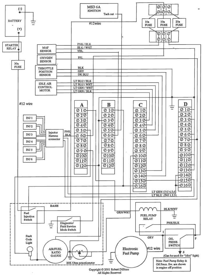

The wiring diagram shows only the wiring associated with the fuel injection system. If you use an MSD ignition as I did, the wiring diagram for it is supplied with the unit or is available from MSD. A wiring diagram for the GM ignition module is enclosed separately in this article if you choose to go that route. The EFI setup is practically "stand alone", and with the exception of the 12 volt connections, ground, and the tach signal connection at the ignition, there are no other connections to your existing wiring.
The wiring diagram shows the terminal strips configured in the same way as the plugs on the ECM. To minimize clutter on the wiring diagram, the wiring between the terminal strips and the ECM is not shown. For example, the wire connecting A1 from the ECM plug to the terminal strip at location A1 is not shown. The wiring diagram does show which input or output signal is connected to A1 (in this case the fuel pump relay). You can also refer to the enclosed ECM connector drawing to determine the function of each wire and where it connects to the ECM plugs.
The color of the wires going to each sensor and the fuel pump relay are indicated on the wiring diagram to help identify the proper routing. With the exception of these, and the wires going to the ECM, you will choose all of the other wire colors, so label the diagram as you proceed. Except for the #12 wires, which are labeled in the wiring diagram, all wires are #14.
Use crimped wire terminals to attach the wiring to the terminal strips. Actually, I soldered all of these terminals as well, but that was very time consuming and probably not necessary. The ones that definitely should be soldered are the wires connecting the oxygen sensor, air fuel ratio meter and the ECM (D7). This is a low voltage signal and small differences are critical for accurate readings. I also connected all of the wires from the ECM to the terminal strips even though many will not be used. This just gave me a feeling of completeness while leaving no loose ends (literally!). I also wasnt sure which ones I might want to use in the future. At this point you can complete all of your wiring per the enclosed wiring diagram, and at your own pace, as you continue to use your car. Just remember two things: leave the 30-amp fuse out of the fuse holder located near the starter relay, and leave the ECM disconnected from the wire harness. Take your time and keep everything well organized. This will really pay off if you have to do any troubleshooting later. Now would also be a good time to install the MSD ignition box or a suitable substitute.

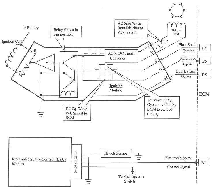

If you refer to my ECM connector drawing you will notice that many of the electronic circuits are listed as optional. Some of these are obvious but others may surprise you. For example, you dont have to use the Idle Air Control motor, or for that matter even an oxygen sensor. I do strongly recommend that you use an oxygen sensor, if for no other reason than to monitor your fuel/air mixture. There are only three sensor inputs that absolutely must be used. These are the tach signal (B5), the throttle position sensor signal (C13), and the MAF sensor signal (B6). With only these inputs the engine would run quite rich because the ECM would always think the engine was cold, and it would always be in the open loop mode, but it would run. Without the Idle Air Control you would not have cold "fast idle" capability, and the ECM wouldnt be able control the idle speed depending on conditions such as whether or not you are in gear or have the A/C on. The ECM also uses the Idle Air Control to maintain an idle speed high enough to ensure that the battery is not discharging, and to compensate for alternator load.
On the other end of the spectrum you can use many of the other circuits for their intended purpose, or to "fool" the ECM as can be done with the potentiometer in the temperature sensor circuit. The timing control circuit is one that has some potential, especially for a turbo application of this setup. You could use the GM ignition module with a Chrysler or Pertronix distributor pickup coil and have the ECM control your timing curve. Or, you could use the module only to trigger your ECM and leave the timing control disabled by not connecting module pins E, R and B to the ECM. (See the wiring diagram for the GM ignition module).
The important thing with whatever ignition is used is that it must generate a DC square wave tach signal. The AC sine wave signal from a magnetic pickup coil, such as used in the Chrysler ignition or a Pertronox conversion, will not properly trigger the ECM. The ECM is a digital device and cant properly interpret an AC signal, so the AC sine wave must be converted to a DC square wave. If you use the GM ignition module to control your timing you would have to live with whatever timing the General had decided was best (no access to the ECM internal memory with a PC here). With the GM ignition module used to control your timing you would also have to disable the centrifugal advance in your distributor. For now, at least, Id rather control my own timing curve.
If you use the GM ignition you wouldnt need an MSD box to trigger the ECM but the MSD has other advantages. Remember, many MSD ignitions are also used on HEI GM cars. You should also consider that if you are still using points you could use the MSD ignition without converting to an electronic ignition. Once the MSD box is installed the points are only used as a low current switch and will last much longer than they would in a standard ignition. Even dwell angle is no longer a critical parameter.
For those of you interested in trying the GM ignition module Ive included a separate wiring diagram for the module that shows how it would connect to the ECM. If you do decide to try this be sure that you use heat sink compound (auto parts store or Radio Shack) and provide a good metal heat sink for the module. I would think a good place to mount it would be in a metal box on your right inner fender.
You might also want to explore using the Electronic Spark Control (ESC) feature of the GM ignition. This is used along with a knock detector to prevent detonation. However, Im not sure you could ever make full use of this function on the SL6 with mechanical lifters. I fear that the knock sensor would detect the tappet noise and drive the timing into full retard. Be sure those mechanical lifters are adjusted if you decide to try this!
Im including all of this so you will be aware of the different possibilities and because I had researched this extensively when deciding how to build my own setup. I do think that the GM Ignition module is a potential low cost alternative. Someone who is interested in racing will have a different approach than someone with a daily driver with A/C and cruise control. The wiring diagram shows how I have built my setup (so far!).

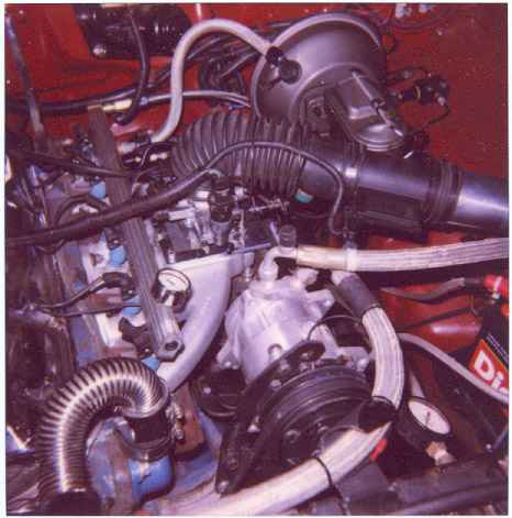

The next major task is to decide how you want to configure the air intake ductwork. I had previously cut a hole in my left inner fender to use as a cold air intake for my Super Six set up. Not wanting to leave this gaping hole unused, I decided to use the same route for my new ductwork. This pretty much forced me to place the air box (filter housing) outside of the engine compartment in the top of the wheel well. As it turned out this worked very well, but did required a lot of fabricating and parts from two different GM air boxes. One half was from a 91 Ciera 3.3L, and the other half was from a 87 LeSabre 3.8L. I think the simplest solution for most would be to attach a K&E cone filter directly on to the MAF sensor so that the filter would be located right behind the battery. This filter would need some support. As I said earlier there will probably be as many different ways of fabricating this ductwork as there will be EFI conversions. Again, it is important that all the ductwork be air tight, but especially between the MAF sensor and the throttle body.
OK, Ill have to admit, I was a little bit chicken at this point! I didnt know of anyone who had ever done this conversion, and everyone I mentioned it to was extremely skeptical. In fact, the more people seemed to know about cars, the more skeptical they were! So, although I was confident (??), I decided to hedge my bets anyway. If you recall I had left my stock 5/16" fuel line in place when I installed my new fuel lines. I now used this line to feed a low pressure electronic fuel pump in the engine compartment. With this I could run a carburetor right up until the time I switched over to EFI. And, now that I have EFI, I can substitute the carburetor for my throttle body in about 10 minutes if for any reason the EFI system fails. I realize most will not want to bother doing this, but I liked knowing I had the option. An added benefit to this arrangement is that I now have a very convenient way of getting gas for my outboard motor and lawn mower! To select the proper fuel line I used an electronic fuel tank selector valve (www.jcwhitney.com, P/N 81ZX2686W) at the gas tank. This valve is connected in reverse, so that instead of selecting one of two tanks it now selects one of the fuel lines. One switch controls both the selector valve and the low pressure fuel pump. This means that whenever the pump is on, the fuel is also diverted to it.

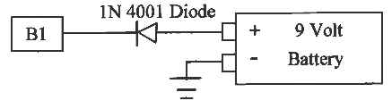

avoid this loss of memory you can place a standard 9 volt battery
with a 1N4001 diode across ECM terminal B1 (12 volt input) and ground
whenever you disconnect the battery. This is optional and will allow
the ECM to retain its memory when the 12-volt battery is removed. It
is important that a diode be placed in this circuit as shown here.
The diode prevents a "melt down" of the 9 volt battery when the 12
volt battery is also in place. The diode is available from Allied
Electronics (www.alliedelec.com),
Allied stock # 568-0141, $0.03 ea. or at Radio Shack stores as P/N
276-1101 (2 for $0.49). Radio Shack stores also carry the 9V Battery
Snap Connectors as P/N 250-324 (5 for $2). I used alligator clips on
this so that it can be put in place whenever desired. I dont
recommend leaving it in the ECM circuit.
