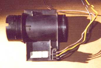

Mass
Flow Sensor (MAF) This is a tubular plastic device, with a
three wire single connector, located in the air duct going to the
throttle body. Get as much of the wiring harness as possible, but
again unplug it from the sensor before cutting the wire. This sensor
is also static sensitive, but other than the ECM, it is the only
other static sensitive device. This item is in big demand because it
costs about $300 new, and it is often missing on salvage yard cars.
However, it can also be found in 1986 and, I believe, 1987 and 1988
3.8L engines with sequential fuel injection. I avoid some of the
later versions that have a Venturi outer shape because they look like
they would be more restrictive. However, Im pretty sure that
they would work. Get two of these while they are still available.
Typical cost: $25 each.

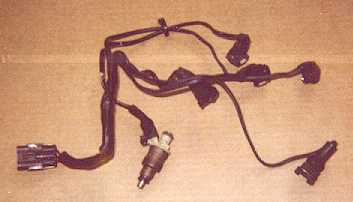

Fuel
Injectors To salvage these you'll need to remove the fuel
rail and then pull the injectors from the intake manifold. They are
often stuck on both ends so bring a tire iron or a large screwdriver
to pry up the fuel rail after removing the hold down bolts. Then use
Vice Grips to pull the injectors from the manifold. I would recommend
getting twelve of these. You'll have to clean and test them (more on
this later), and after 15 years of service the "yield" may be
disappointing. Also get the fuel injector harness, and as much of the
main wiring harness from its plug back to the firewall as possible.
Typical cost: $5 each, plus $5 for the harness.

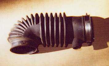

Air
Duct This includes all of the ductwork that will be used
between your air cleaner and the throttle body. It will also house
the MAF sensor. It is important that this ductwork be air tight,
especially between the MAF sensor and the throttle body. Any air leak
here is referred to as "false air" because the MAF sensor will not
detect it. This condition will result in poor engine performance.
There will probably be as many ways of configuring this ductwork, as
there will be EFI conversions. The one piece that's critical is the
piece connecting directly to the throttle body. This piece must make
a sharp turn to allow for hood clearance. I found the one I used
(pictured) on a 1985 Buick Park Avenue with the 3.8L engine. It seems
to be unique to that model and engine. You'll have to plug the hole
that was used for the crankcase breather tube. In our application
this piece is used after the MAF sensor so a breather tube connected
here would introduce false air. If you use a breather tube it will
have to be placed before the MAF sensor. Typical cost: $10.

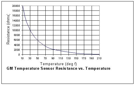

Potentiometer - 20K ohm (optional) The ECM normally monitors the engine temperature by reading the electrical resistance of a temperature sensor. At start-up the engine is cold, the sensor resistance is high, and the ECM provides a wide injector pulse width for an enriched cold start fuel mixture. As the engine warms the sensor resistance decreases, and the ECM reduces the injector pulse width to lean out the fuel/air mixture. One of the performance modifications often suggested for fuel injected engines is to use a lower temperature thermostat. This "fools" the ECM into maintaining a rich mixture for maximum performance. With our custom fuel injected SL6 we can do better than this! By using an adjustable resistor (potentiometer) in place of, or in series with a GM temperature sensor, and with the aid of our air/fuel ratio gauge, we can have manual control of our fuel mixture during open loop operation. By mounting the potentiometer on the dash we can use it at start-up just as we would use a manual choke (if we don't use a temperature sensor). And, we can also optimize for performance at the stoplight (with or without a temperature sensor)!
If
you do decide to use a temperature sensor your stock one will not be
sufficient. The GM temperature sensor has a much broader resistance
range than the SL6 temperature sensor.
