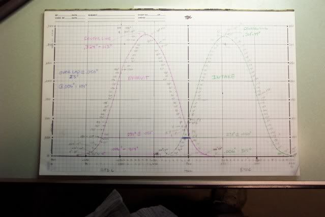

2. I’m going to degree the cam later this fall once the car is put away for the winter, and see if there is a problem with it.
2011, o2 sensor did get installed late in season, it did help tuning the old Holley 390, and by early fall of 2012 I managed to sort out most of the jetting & engine tune issues.
Winter of 2011 I did degree the cam, found a healthy lift and big overlap.
I discovered this engine easily cranks to 6000 + rpm. Having found and talked with the guy that built this car he dragged it for four years c. mid nineties, at Englishtown, NJ, winning his bracket several years in a row, and when asked what he used for a red line stated; I got the biggest cam Clifford had, shifted at 6300, and blew up five engines before figured out how to build one that would stay together…
