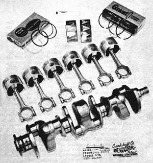

Here are a few pics showing the before and after of the first steps of crank lightening.
Stock Crank Cheeks:
Ball Milled Crank Cheeks:This is done to the front and rear of each journal. Good time to knife-edge while its in the fixture!
