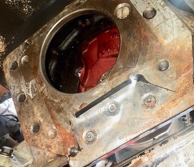

The previous owner did all the work.
from what i can gather its a 1961-1968 DODGE TRUCK HYDRAULIC BELL HOUSING 2235714-1 318 LA318 POLY SLANT SIX.
This looks to be all the modification to the bellhousing.
He has drilled and tapped 2 holes for the bottom of the gearbox to mount to. Possibly had to do the top 2 as well. There's a custom cross member under the gearbox as well .
