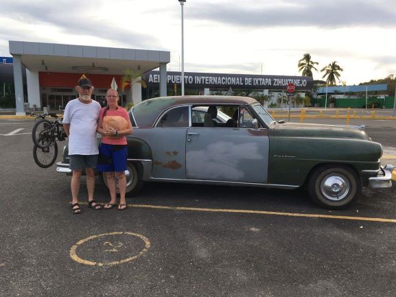

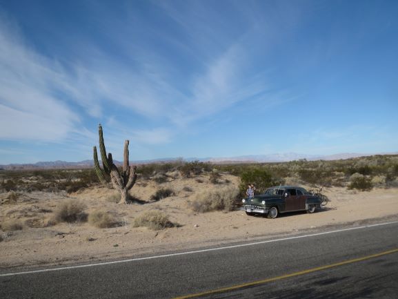

Hers a pic Andy!

Good thing you have the bike rack installed for your personal mpg trials :-)

No bike rack for mileage tests.
