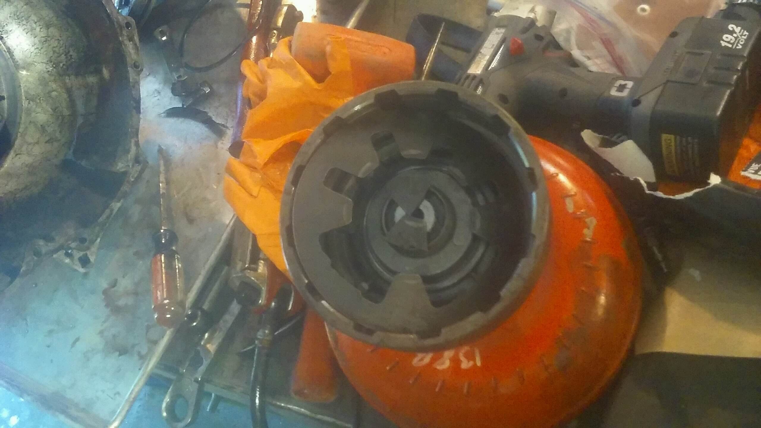

Don't know if you can see it well but one of the fingers from the front clutch bellville spring broke off and lodged between the spring and the piston. That appears to have stuffed the clutch. $4 part. bought the kit for $89. I did begin to remember what I was doing after a bit. It has been 35 years :-)

Wow... the first time I have seen that failure.
The good news, a cheap part and not a lot of metal shavings to clean-out of the system.
