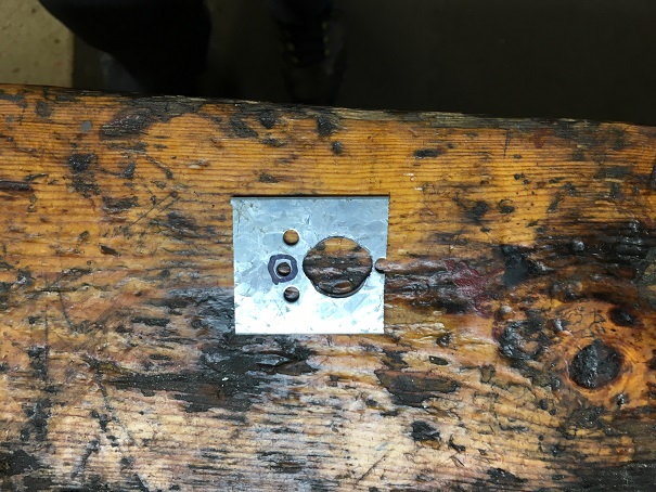

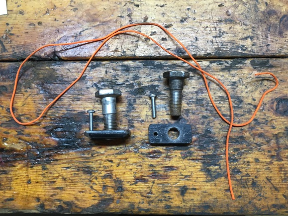

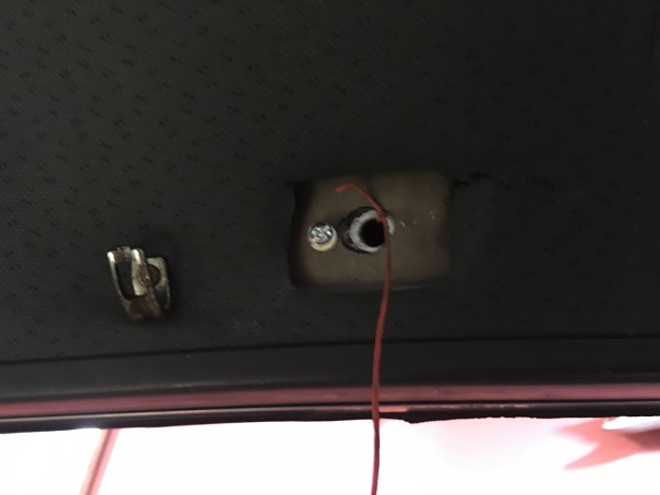

I followed what was done previously but made some improvements in the process. From a gauge that simulated the install hardpoint I was able to develop an EZ process to locate and hold the backstop during installation. The gauge also was used as a template to mark on the car bracket the amount to open up the OE mount hole and to locate the set screw hole. I have posted photos below, but the detail is at the link.

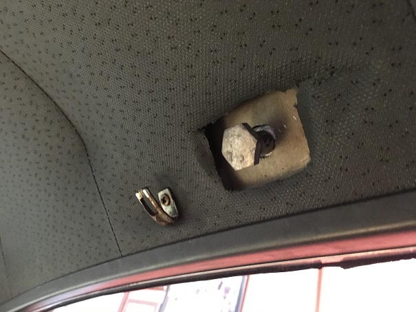

This was a good find for me as I was able to get functional shoulder belt mounts without a tear up on the original and in fairly good shape headliner.
File comment: gauge used for prototyping the process and marking the location to drill the set screw hole in the car bracket

File comment: parts,, the puck is 1/4 inch thick, about .750 wide and 1.5 inches long

File comment: the backing puck with the string attached and the set screw started

File comment: shoulder harness bolt install complete
