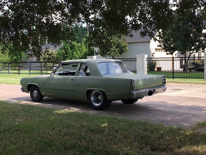

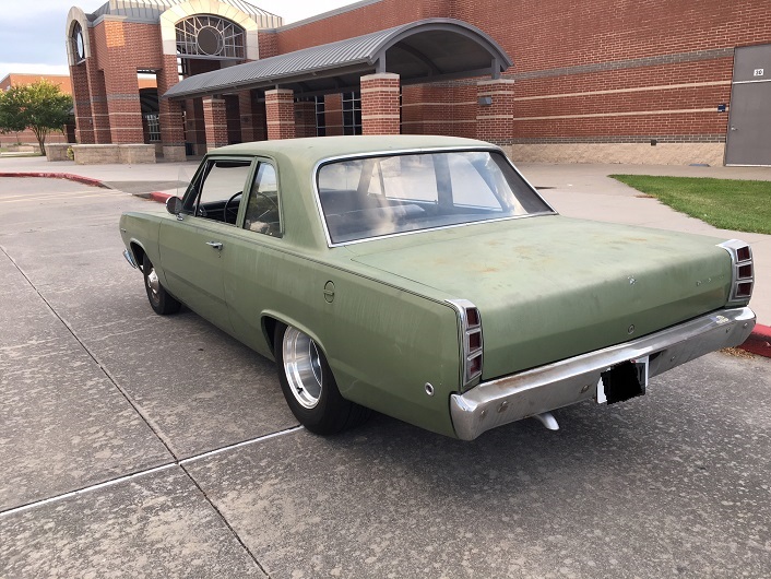

Made my first voyage today with the Valiant...the 13" rear tires were so dry rotted I was afraid to drive it fast or far. So...I had some 15" Nitto's off another car I decided to use. That required some surgery and a change to an 8-3/4" rear. The gears went from 2.76 to 3.91, too...though with the larger tires it's actually like I changed to 3.14's. A nice improvement in pep.

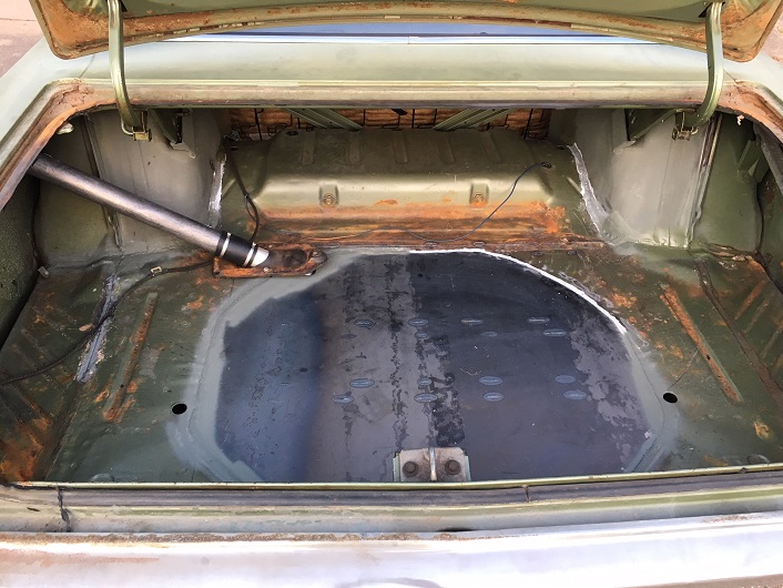

I also got rid of the stock gas tank and went to a flat floor, no more spare tire well. The new tank provides way more exhaust pipe room on both sides as well as bigger fuel outlets in case I ever need them.

Thanks again. The rear is actually 1" lower than it was 'stock' but the tires make it look higher.
Exhaust? Well....you'd need a really loud V8 - reeeally loud - to drown out those gears! They're actually quiet under acceleration, mostly. But in the transition from accel to coast, they scream pretty good! I have another 3rd member with 4.10's that are good so that might be the easiest way out.

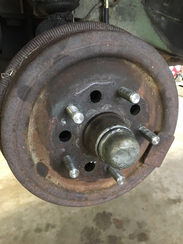

Thanks. I redrilled the fronts. There's plenty of meat there. The trick, in my experience, is to never separate the hub from the drum. I drilled and tapped them together (1/2"-20)and installed the new studs before driving out the old studs. I didn't bother measuring runout with a dial indicator because...the eyeball indicator shows there is essentially no runout.
I have at least one complete set of good discs/spindles I could have used but I want to retain the lightness and compactness of the drums. If I ever get inclined I might change to discs but it'll be Wilwoods or something similarly light.
