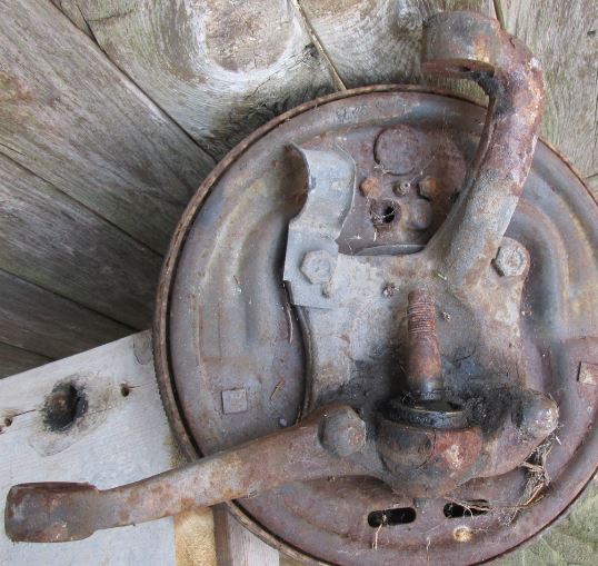

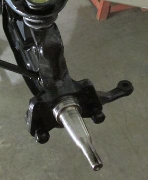

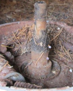

PostPosted: Fri Nov 08, 2019 9:29 am
Posts: 2488
The black one is my 10 inch on the car.
The crusty ones are 9 inch.

 Post subject: Re: spindles
PostPosted: Fri Nov 08, 2019 2:16 pm
Posts: 245
Notice how the upper ball joint stud hole is twisted around 90 deg compared to the 10 inch one.
PostPosted: Fri Nov 08, 2019 3:40 pm
Posts: 8968
Brian
Yep, that was my concern. Wanted to make sure the ones on the "K" member were correct, before starting to order parts.
