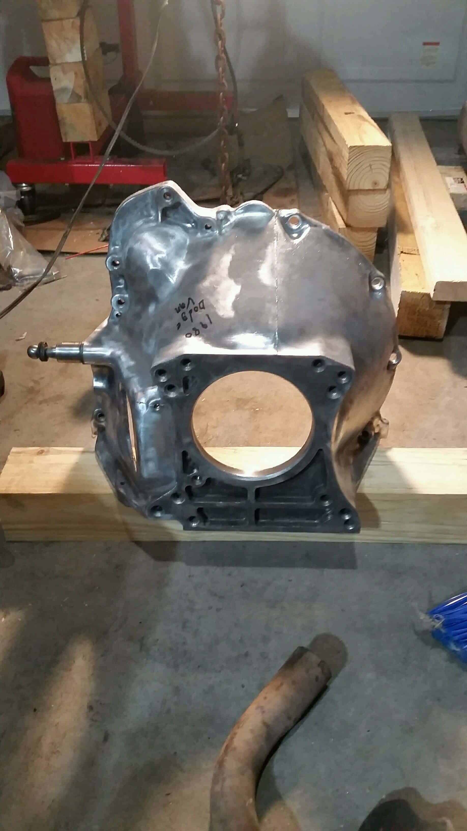

PostPosted: Mon Dec 16, 2019 4:38 pm
Posts: 3848
am I in trouble
the easiest and surest way to identify what you have would be for you to post photos of the transmission and bell housing.

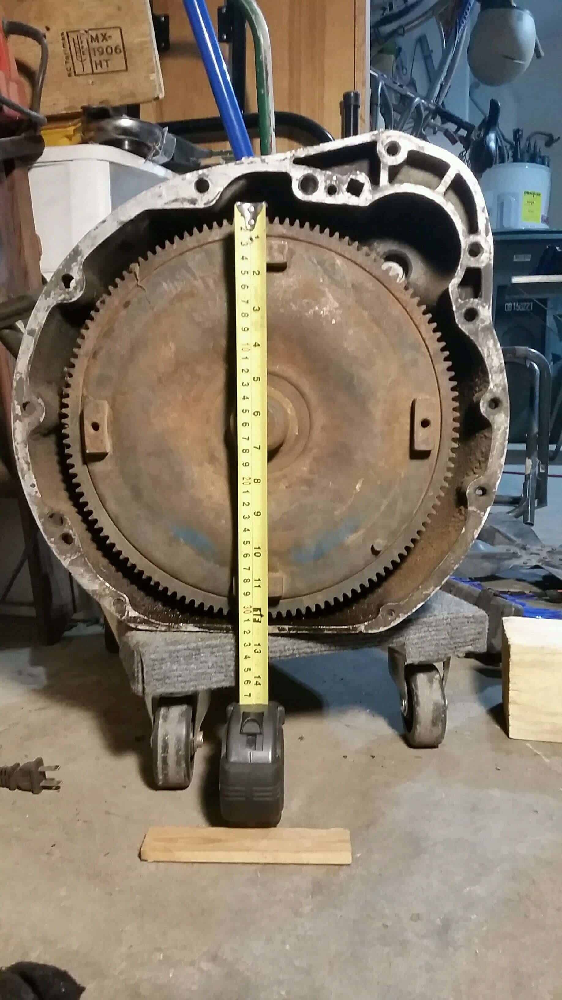

PostPosted: Mon Dec 16, 2019 5:18 pm
Is there a way to inspect the bell housing to see what size flywheel would fit into it?
Measure the mouth from side to side (not at the starter pocket...).
1b. If I have the V8 flywheel housing am I in trouble trying to line in up with my slant 6?
None...or with a rare adaptor a few more Benjamins.

PostPosted: Tue Dec 17, 2019 12:26 pm
Posts: 156
Car Model: 1962 Dodge Dart
Hi all,
I have some photos here. After counting the teeth on the...ring gear?...on the auto torque converter I have confirmed it does indeed have 122 teeth.
1. DusterIdiot: Measurement side to side was about 14 1/2". The measurement across the ring gear was about 12 1/2".
2. 99% sure I have a slant 6 bell housing based on comparison to my auto trans.
