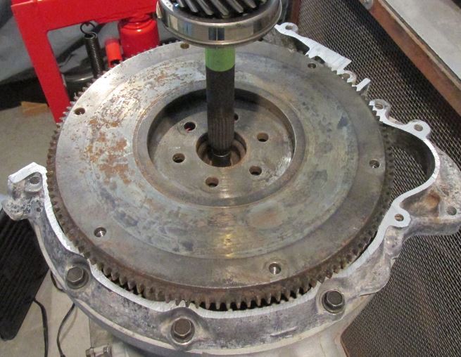

Not sure about casting numbers, but here is a 130 tooth flywheel and a cut down stock 3 speed bellhousing.
You can see how the 130 flywheel hits.
Starter would not fit either due to increased diameter.

Looks like I'm going to have to use the 122 tooth flywheel with bellhousing that I have. The ring gear is 12-3/8 across. So I checked the distance between center of bell to starter gear is 6 3/16.
