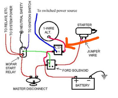

PostPosted: Mon Sep 07, 2020 4:43 pm
Posts: 3848
why not use a starter relay like a Ford?
A Ford starter solenoid is an option.
Remembering what uncle E used to say 'make everything as simple as possible, but no simpler'...
With that in mind, either using a Ford Solenoid or a Circuit Breaker requires inserting an electro mechanical device in to the vehicle wiring.
Its not like one option requires nothing and the other one requires a huge amount of effort. They both require a little bit re configuration.
The Solenoid is probably a bit cheaper than a high amp DC breaker, but the Solenoid requires more wiring and connections than a single breaker.
The schematic attached below shows a second constant duty relay required along with the Ford Solenoid, so perhaps the Ford Solenoid option requires that two devices be added.
Even with the Ford Solenoid there is still a hot wire going from the rear mounted master disconnect to the under hood Mopar starter relay, so its not like a Ford Solenoid provides protection to all of the rear to front circuits.
The Circuit Breaker when tripped will knock everything off line to the battery at the main battery connection. And I already have a rear mounted main power disconnect that when
switched off kills all power except the car alarm. For me that is a simple system.
High Amp DC breakers are available.

PostPosted: Mon Sep 07, 2020 5:31 pm
The master disconnect should be right after the battery.
The way you have it, a stuck solenoid can still supply power.
PostPosted: Mon Sep 07, 2020 6:17 pm
Posts: 3848
That is not my wiring diagram. It is one that gets a lot of use over at FABO.
