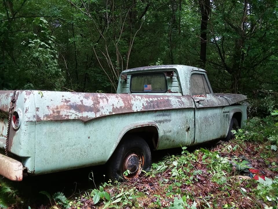

I have dragged home a 64 Sweptline long bed that was in need of rescue. It has the 225/3 speed and I'm going to fix it up and just enjoy it as a thoroughly tired truck. Motor is wounded , so I picked up a donor a couple weeks ago to replace it with. After getting through the motor and tranny (resealing donor motor , timing set , fresh clutch.......) and brakes (Truck sat over a decade in the woods) , it will be on to the body work. More like , it will be on to putting floor pans in. I have some experience in this endeavor , I've owned a couple Scout II's.
As a child , the cars I remember best were Mom's Fury , then there was a Duster (318) , Valiant (slant 6) , a Volare with a 225 Super slant in it. My pick up's have both been Dodge (75 Power Wagon , 88 Power Ram). This is my first dance with an older Dodge pick up.
I will ask a lot of questions , but I'm also a big time user of the search function on forums. I've been doing a lot of reading for the last month or so on here , and thought it would be nice to introduce myself.
The motor I pulled , as it turns out is an early 76, so it's not original. It was plainly missing the head with spark plug tubes. Had it been the original , I would have been more inclined to dive in. I am going to shelve it and see what the future brings. The one I picked up , was pulled from an early 80's pick up , but the block indicates it was built 68-75 , and it has spark plug tubes. seems these things get around.
I will post a few pics up. She is NOT a looker , and that isn't my intent to turn it into one. More like , get it dependable , and safe , and let it tell its own story of survival. My purchase required a chainsaw , a full sized 4x4 , and a 10,000 lb. winch. I'm getting off on the right foot anyway.

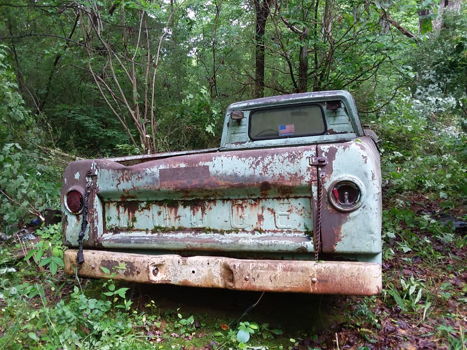

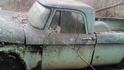

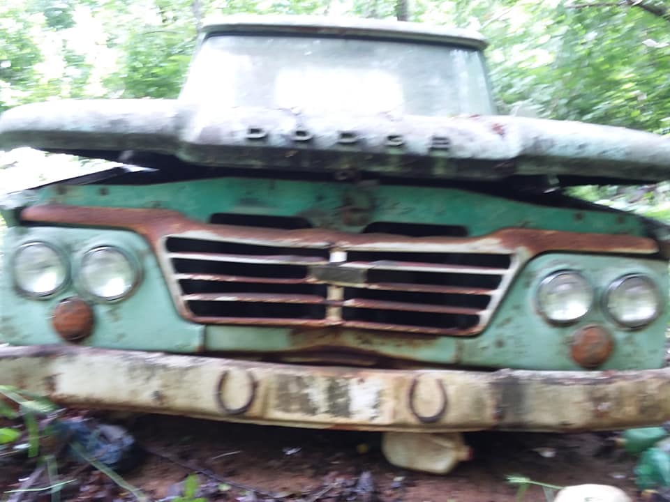

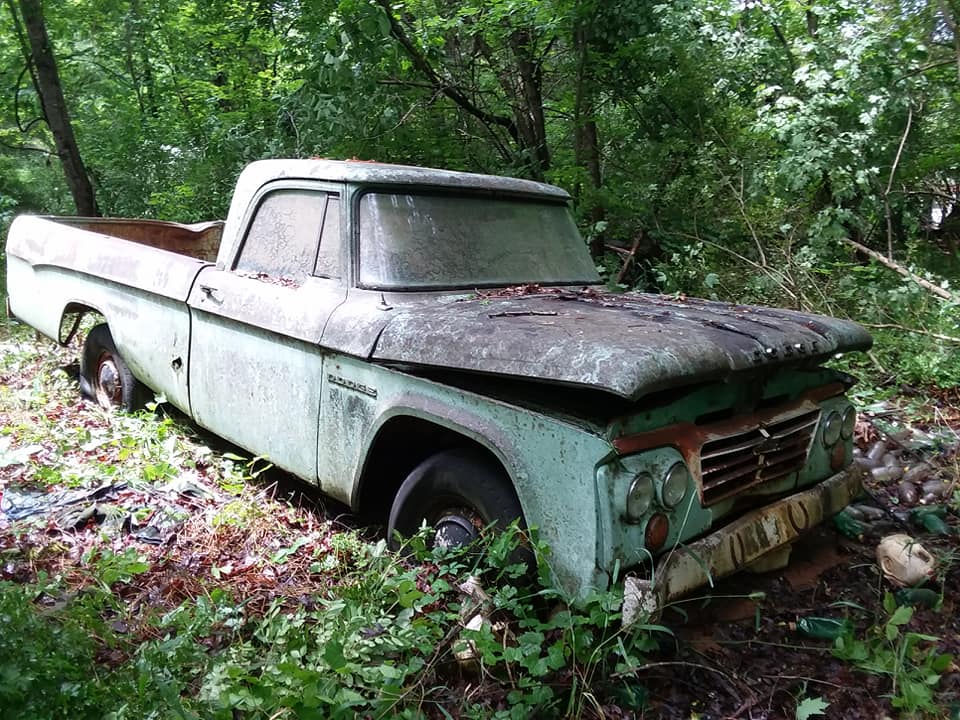

This is it the day I pulled it out of the woods.

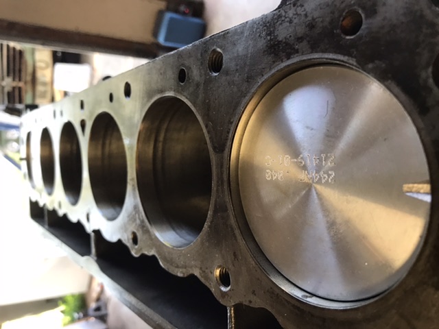

Well , it's been a minute , but I jumped back on my 225 this weekend. I do have a question , the kind of question that is going to make most of you guys roll your eyes and move on , but here goes: Why does the piston stay a 1/4" down in the cylinder at TDC on the 225? I found exactly 1 picture (over on Abodiesonly) that looked like mine. I brought work to a halt trying to figure out if if I had mixed up parts (I'm using two 225 motors to build one good one) , but when I rotated the piston to BDC , it was 4 1/4 (ish stroke... I used a tape measure) , and I measured both sets of rods from the motor I am using , and the parts motor , both the same.
I've never rebuilt a slant , have a 318 , and a number Japanese motors , as well as GM cast iron V8's. On those , the piston is right at the top of the block TDC , not almost to the top. Anyway , until I found that picture last night , I was a little thrown.
Thanks ,
Dan

Pic of motor

Yes, this is 'normal' on a slant. It is not a 'zero deck' motor in stock form. This is why most slants average 7.5-8.5 compression from the factory.
PostPosted: Tue Sep 08, 2020 5:24 am
Posts: 8968
Actually a 170 slant is a zero (or close to zero) deck slant. The 225 and 198 have the piston down in the hole. Just a FYI
