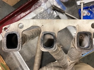

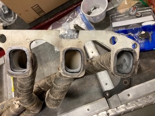

Getting ready to pull the existing motor from the 68 Barracuda to be able to install the newer-better next motor.
Noticed at the header flange the inside of the header tubes for cylinders 1,2,3,4,5 had bright white - clean carbon.
The header tube for #6 cylinder had a much different appearance, the first couple of inches in it was black and sooty.
File comment: header cylinders 1 2 3

File comment: header cylinders 4 5 6

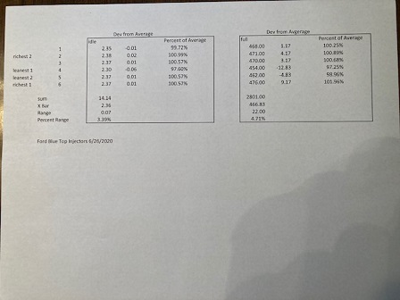

I received the injectors and test data back from Will. Thanks Lou, that was a good tip.
Will was great to work with. This forum has superb support.
It appears that the injectors are fine, although the #6 injector was the richest in the group.
Below is a table with averages and percent of average.
At idle the injectors were all within 3.4% of the average
At full open the injectors were within 4.8% of the average
No test data to support this, but it seems that cylinders 1 and 6 would tend to get less air flow due to the longer intake path,
and cylinders 3 and 4 would breath the easiest, due to the short runners.
I will put the injectors that flow the most in cylinders 3 and 4 and the ones that flow the least in 1 and 6.
