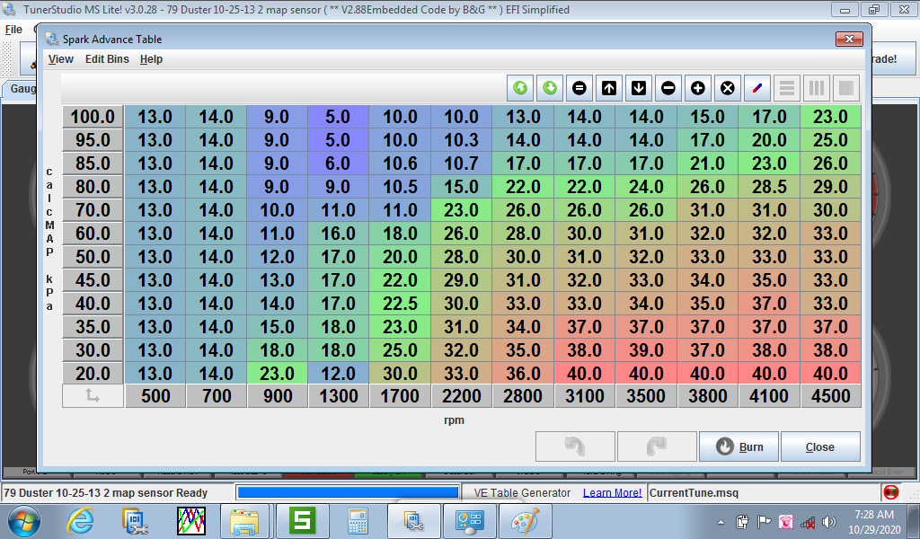

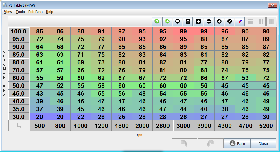

PostPosted: Thu Oct 29, 2020 8:13 am
Posts: 9980
I am not sure how helpful these will be as I believe the maps are for each specific build / type flow rating of the injectors ... if nothing else it will be a nice picture of numbers.
Here is a file too. for what it's worth.
https://drive.google.com/file/d/1l8yHQ- ... sp=sharing

The VE tables are designed to be independent of the injector size - the ideas is to have the injector data elsewhere, so if you swap injectors the only thing you have to tune is injector data itself.
I sent Frank a copy of my tune as well, but it is a very rough tune as the tuning got cut short when I lost a rod bearing.
