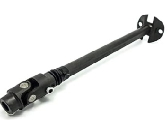

The slip coupler is where the play is and my intent was to rebuild the internal guts, but I'm going replace with a steering shaft assembly.
