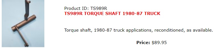

This was the issue.
 Post subject: Re: Clutch Question
PostPosted: Wed Jun 23, 2021 11:19 am
Posts: 9985
I had a similar problem..
Those can be fixed!
https://www.slantsix.org/forum/viewtopi ... A+body+bar
PostPosted: Wed Jun 23, 2021 5:10 pm
Joined: Thu Mar 26, 2020 8:11 am
Posts: 29
Car Model: D150
Brewer's Performance, Inc
10510State Route 571
Laura, OH 45337-8799
http://www.brewersperformance.com
They're nice people over there, had everything I needed. New torque lever with bushings.
And I found them by sending an email to a guy on eBay selling a peddle assembly.
Ya just never know.

I've cut the arms off and rewelded them to a "new" hunk of pipe before, to solve that problem.
