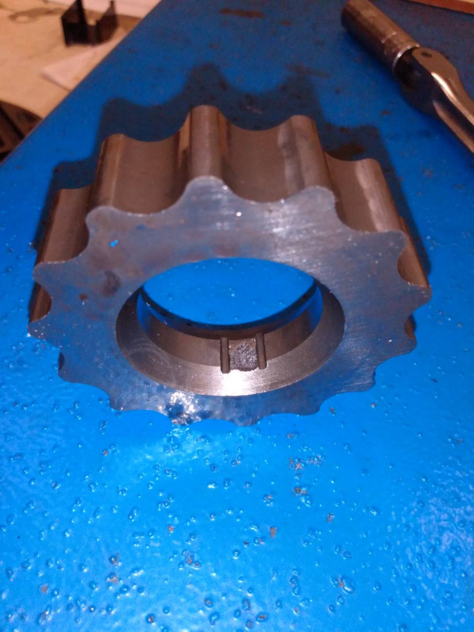

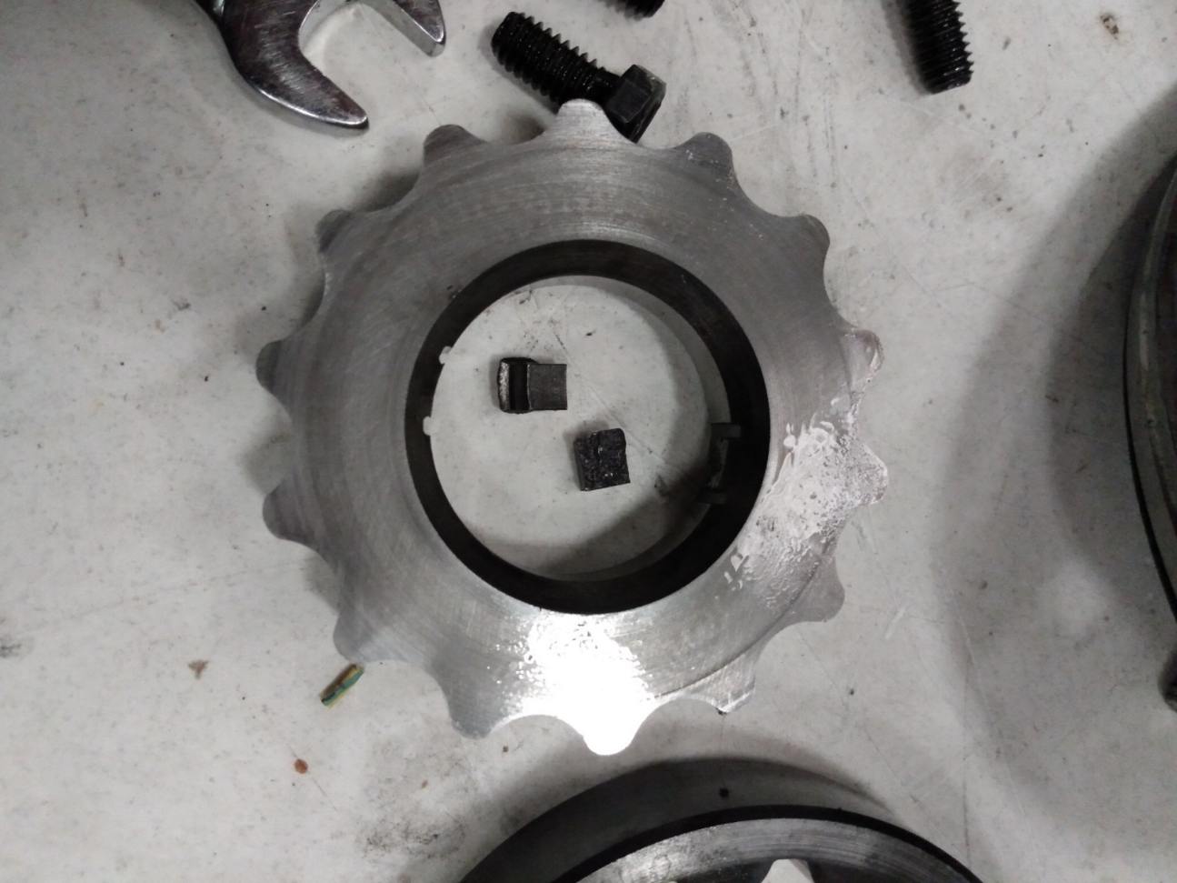

Got the pump out, and got my answer to how bad it is. Looks like it's confined to the pump gear.

Remember that "snap" you heard..!?
That was it .. Good thing you pulled it apart.
New drive gear and you are in business!
