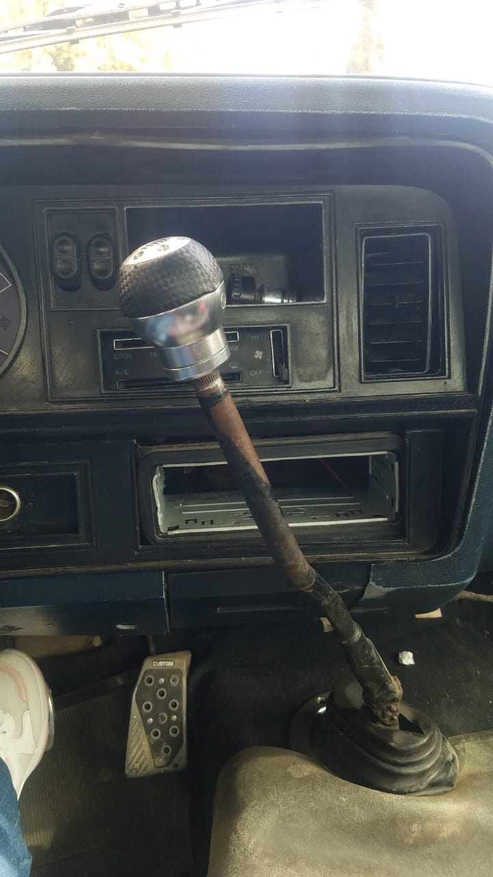

I don't think I have the OD 883 transmission though

Posts: 209
With the 833 OD transmission your truck will have the 10" clutch. The large "truck" transmission uses an 11" clutch. No 10 1/2" clutch behind a slant 6 that I know of.
This is the picture of the shifter

PostPosted: Wed Feb 02, 2022 9:03 am
Posts: 9055
You are correct that is not the 833OD
PostPosted: Wed Feb 02, 2022 10:26 am
Posts: 209
So would that mean that my truck has the 11" clutch ?
PostPosted: Thu Feb 03, 2022 3:12 am
Posts: 9055
Probably, but there is an oddball "recessed" flywheel, clutch and pressure plate that they used also. These are not available anywhere that I have found including Chrysler. Here is the link to our problems and work around.
