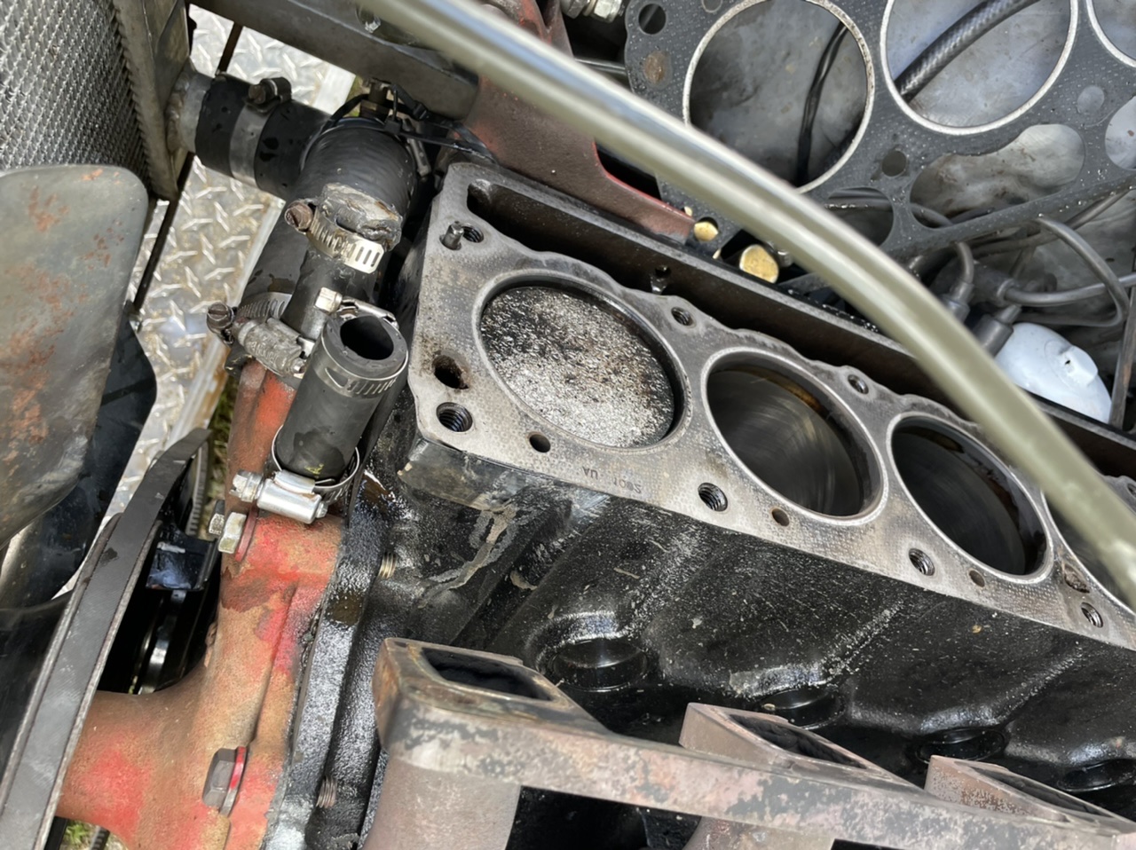

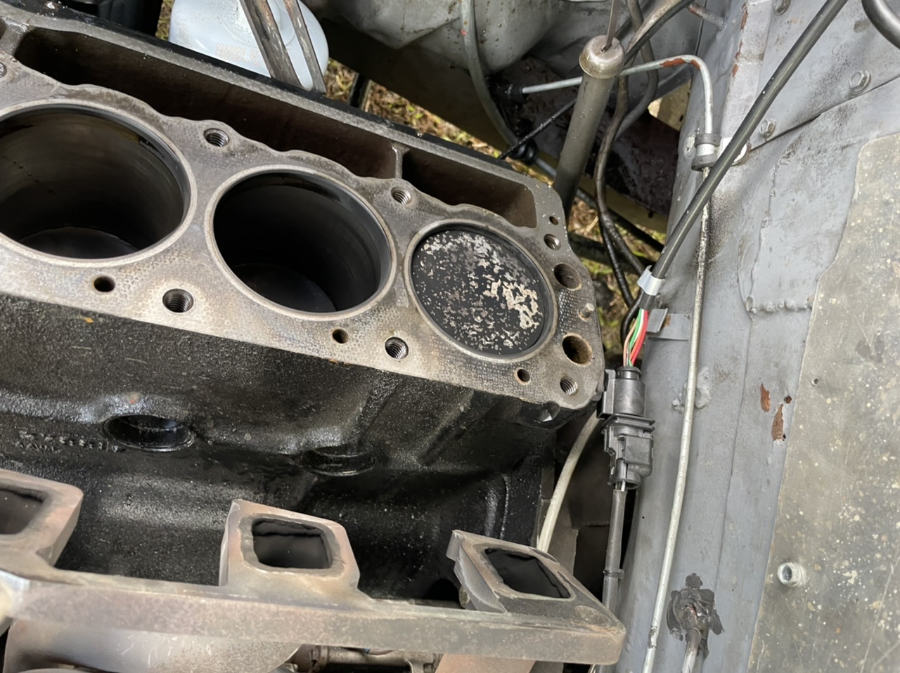

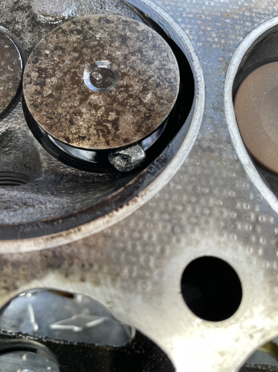

This time the nut we added to keep the stud in place only went through 1 and 6 and was caught before catastrophic damage was done. We removed the head, verified we could still go on, replaced one valve and she fired back to life. Ready to hit the track again.

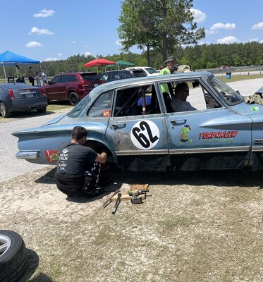

Pics or it didn’t happen, so…
