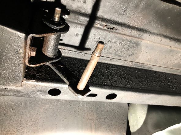

Got the old leaf spring off, but I can' figure a way to remove the rear hanger/bushing... The nuts seem to be inaccessible.... or are there captured nuts behind those bolts?
Help, pls.

IIRC, the bolts just thread into the frame.

Yes they should just bolt into the frame box there.
If you got a wrench/socket on 'em and they are spinning then you might be having to cut the bolt heads off.
