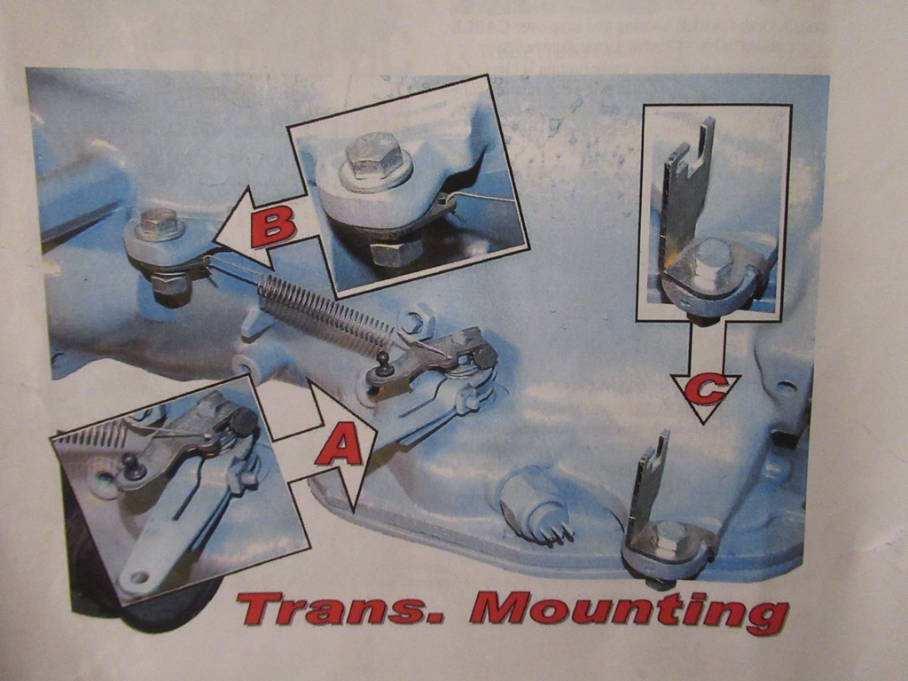

I have a 1965 Dart with a 225 and a single barrel carb. I am going to a Super Six 2 barrel intake manifold with a Stromberg 2 barrel. I have been reading the directions from Bouchillon on the kick down kit that I purchased. The directions are good and have good pictures. But I am a little confused on the transmission brackets. (See attachment). If anyone has installed this kick down kit please feel free to share any input/direction. I know that I am going to need to fabricate at the carb for attaching the kick down. I have hung a Lokar gas peddle and am going to use the Lokar cable.
1. Is bracket C the front of the transmission? I for some reason am confused on the orientation of the cable, throttle lever, and spring bracket.
2. It says at idle the throttle valve lever on the tranny should be forward? And at wide open throttle it is all the way back.

Bracket "C" is at the rear of the trans, bracket "B" is at the front of the trans.
