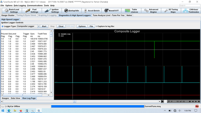

Seems to work. Cam pulse is about 8 crank teeth (36-1 crank wheel) after the missing tooth... so 14 teeth after tdc?
Idle smoothed out going full sequential. Time to drive it around...

Other random fyi’s….
The diyautotune sensor is active low… need to change tunerstudio option to falling edge.
There’s plenty of oil slinging around in that area. Don’t forget to put sealer around the sensor base before bolting it to the plate. Thought I could get away with it…. Oops.
