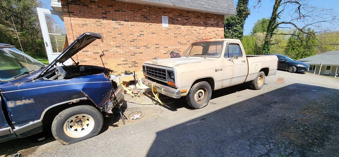

So I bought this '83 D150 short bed, I think it might be the Miser trim but I am not sure, with a factory slant 6 and A-833 OD, and manual steering of all things. I originally bought it to swap the 318 from my late fathers 1983 D150 into, but have since realized sourcing a bell housing is not only difficult, but quite expensive. So I've decided to leave this truck and it's slant-6 mostly alone and simply enjoy it. It was sitting for around about ten years, one owner, dunno what happened to him, he moved to Florida from Virginia and vanished.

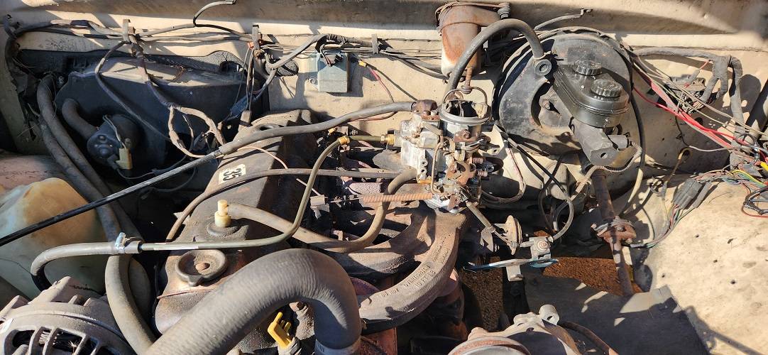

Rebuilt the Holley 1945, accelerator pump was still iffy at best
Removed Holley 1945, installed with an adapter a Carter / Holley BBD from the 318 in my Dad's truck onto the Slant 6, seems happy now
Repaired a metric ton of hacked and cobbled wiring

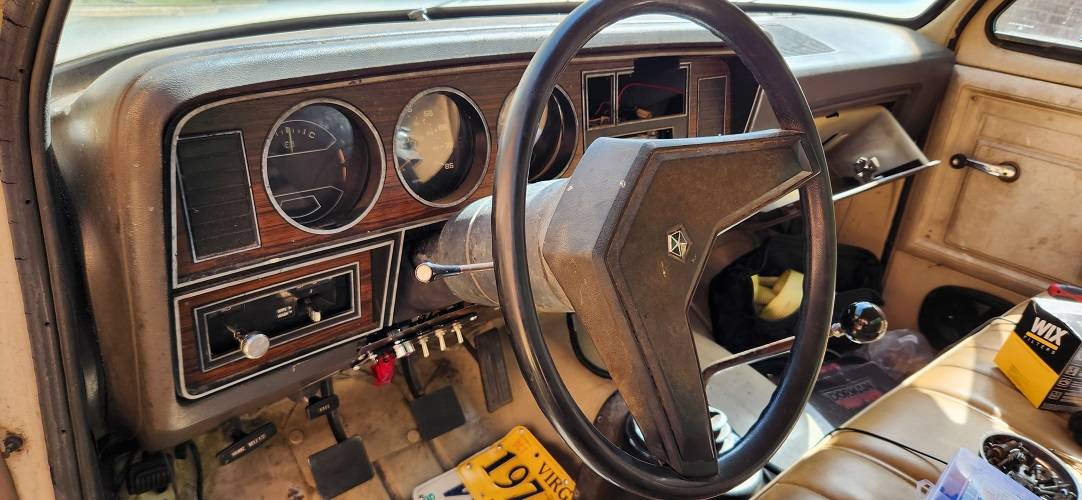

Wired in a push button start panel with extra switches for things I may add later, it was cheap and works, it goes directly to the factory relay

installed the plood dash bezel out of my Dad's truck as it was the least butchered and nicest of the two I had

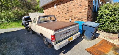

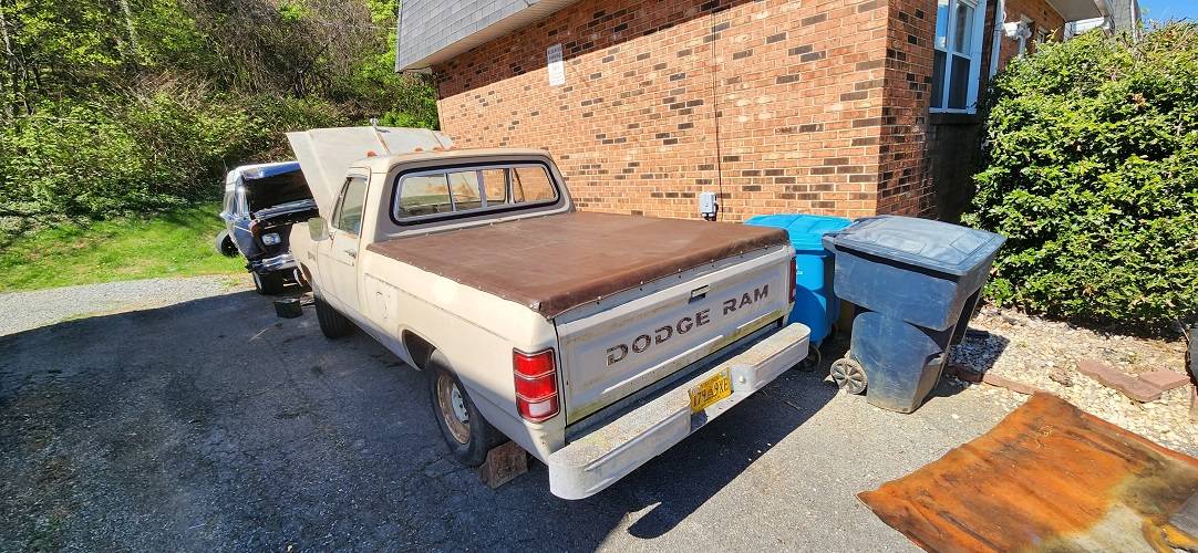

Installed the tonneau cover for the hell of it

bought a random dorman brand blank shift knob that kinda fits since mine was missing
Removed all the extra vacuum crap related to the Holley 1945, down to just the fuel vent on the carb to the charcoal canister (Not vacuum but it's an extra hose), PCV, and distributor advance, brakes are off the manifold. Had no idea what that giant vacuum UFO octopus thing did, it wasn't hooked to anything when I got the truck, so it was gone too.
New fuel filter, hoses up front, probably need to check the tank hoses.

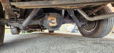

So, below is the truck, named Dale, the reason will be apparent when you see the differential. I never had the opportunity to meet the original / previous owner, but I know he bought the truck new in Burlington NJ, it was in my neck of the woods in Southwestern VA by 1992 or so, and was sold around 2011 or 2012 and there it sat until the beginning of 2023 when I bought it. Pretty much rust free save for the hole in the drivers side floor due to the leaky (non-existent) door seals. Being a northern truck it's got more paint and undercoat on the frame than I know what to do with, so there's that to fall in my eyes along with dirt, so that's great... Anyway, enough rambling, here's the truck:
PS the BBD 2bbl air cleaner does fit, hood closes, but I can't upload more than 5 attachments sooo, you'll just have to believe me unless someone replies, then I'll attach it to the reply :mrgreen:
