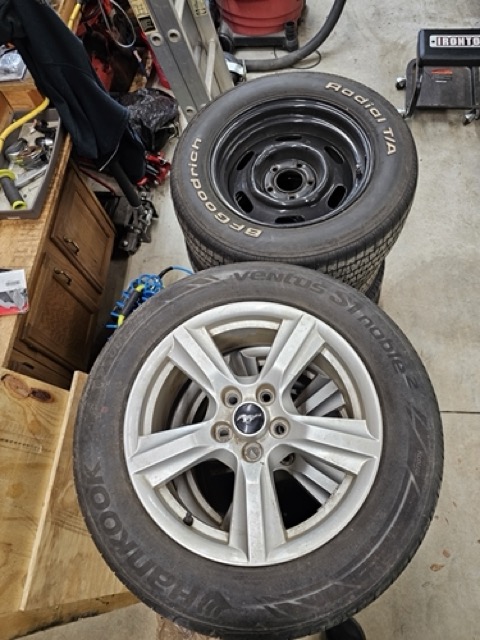

I'm working on modernizing a '63 valiant, and want to upgrade to 17" wheels. Tire selection for 15's just isn't very compelling anymore.
I got a set of 2019 Mustang rims for a good price recently, and am trying to figure out how to make them fit. I know some of y'all here have bored out the center hubs to fit the mopar hubs. I'm thinking. can make them fit without doing that and am curious if anyone else has done so.

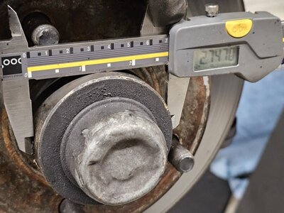

I measure the hubs on the Mustang wheels at ~2.76". The mopar hub I measure at ~2.81. However, due to the offset of these wheels, they're naturally not even close to sitting on the stock flanges. Measuring the disk brake hubs on the front, they're ~2.74" past the Mopar hub diameter at the base.
The cop car rims I have measure about a 9mm positive offset, and these mustang wheels have a 37.5mm positive offset. This gives about a 1.1 inch spacer to achieve mopar factory offset with the mustang wheels.
My thought is that I can machine spacers in the back that have a Mopar hub on the inside, and a Ford hub on the outside. Then do the same for a set of spacers on the front. I'll also need to swap out the wheel lugs to be an inch or so longer. By doing this, I can preserve the factory offset (and scrub radius) for the front, keep a factory Mopar spare in the trunk in case of a flat tire, and avoid modifying the Mustang rims in the event that I want to change them for something else in the future.
