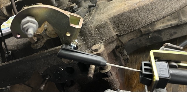

Hey could anyone post pictures of the carb end of a Bouchillon kickdown cable setup on a 2 barrel Slant Six with a Carter BBD carb using the stock throttle cable mounting location? I bought the Bouchillon kickdown kit and it looks like the supplied carb bracket needs to be cut down to work on the BBD but before I start cutting, I'm hoping to get some confirmation. I have spent too much time searching online only to find nothing! Many thanks in advance!

Here's a mock-up so far--looks like the carb bracket has to be cut and the kickdown cable bracket has to be mounted on the outside of the stock 2 bbl accelerator bracket with the accelerator cable moving to the inside.

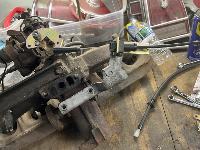

Update: I cut the carb bracket along its right edge and cut the throttle nut per the instructions. I also ground down the splines on the throttle cable bolt so it sits as flat as possible under kickdown cable. Finally, I drilled out the roll pin, disconnected the bracket it was holding on, then inserted the small nut and bolt through the hole where the roll-pin was.
I think this is correct but still hoping someone can verify. Thanks!
